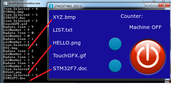

I am using scroll List and also able to select the item by clicking that and tested that on simulator. Please check below image .
Screen1View::Screen1View() :
	scrollList1ItemSelectedCallback(this, &Screen1View::scrollList1ItemSelectedHandler)
void Screen1View::scrollList1ItemSelectedHandler(int16_t itemSelected)
	touchgfx_printf("Item Selected = %d \r\n" ,itemSelected) ;
	touchgfx_printf(Rx_Buffer1[itemSelected]) ;
 // Which API should I use ..
	touchgfx_printf(" \r\n" ) ;
void Screen1View::setupScreen()
	 Screen1ViewBase::setupScreen();
	 scrollList1.setItemSelectedCallback(scrollList1ItemSelectedCallback); // Added
How do I change color of Clicked Item (Text) or put rectangle over that .
Means which API should I use .?

Here is an example on how to modify elements of an item (change color, change text, etc.) in a ScrollList when this item is being clicked.
Hope this will help.
/Alexandre
/Alexandre

Here is output video on simulator .
