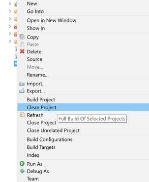

Could you please ensure that the required header files are added to the Paths and Symbols under C/C++ General settings in the project properties? Also, it would be nice to do a project cleaning and compile again.
Cleaning ProjectCleaning Project

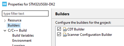

I tried disabling the Scanner Configuration Builder, but didn't seem to make a difference:

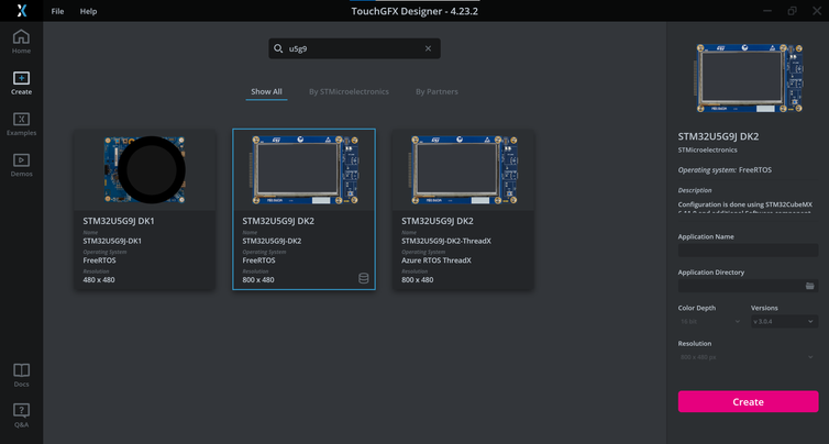

In the STM32U5G9J DK2 project that TouchGFX Designer creates, make -j16 is used for the STM32CubeIDE project build setting (Parallel build). I'm now a bit suspicious about other possible changes in the project properties.
STM32U5G9J DK2 TouchGFX Board SetupSTM32U5G9J DK2 TouchGFX Board Setup
Could you please share your project?

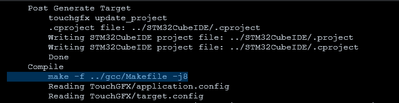

To my knowledge, both the IDE and TouchGFX have always used `-j8` in their compilation.  Snippet of TouchGFX build below:

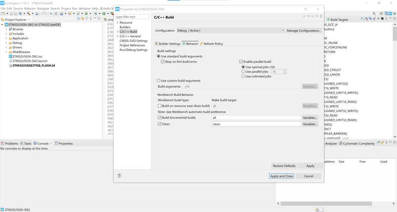

Yes, TouchGFX uses -j8, however, the default settings for STM32CubeIDE in C/C++ Build -> Behavior should look like this:
Default build settings used by generated project from TouchGFXDefault build settings used by generated project from TouchGFX
Although, I don't think the issue stems from these settings because I'm not able to replicate the issue you are talking about. And, as I mentioned earlier, from the error that you have attached, your custom-added files are not correctly recognized by the compiler. But, I don't understand how the 'second build' can be successful if there was an error in the first one.
