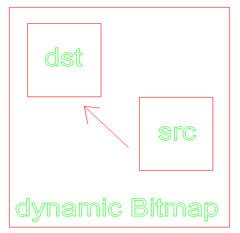

Hello everyone:
I came to a need,that I need to copy part of a dynamic Bitmap to another postion of the same bitmap.I current use a for loop and memcpy func,It works but cost 4ms each run.How can I use touchgfx's blockCopy functions to do this? as DMA2D was already enabled.

Hi amb
We don't have that operation, but I think you can make one.
first call HAL::lockFrameBuffer. This will wait for the DMA to finish all operations.
call unlockFrameBuffer also.
Now, DMA2D is idle and we can use it.
Two ways:
Go to your CubeFW for the board (or another board with DMA2D and display), find the DMA2D examples.
For F746Discovery, for example this:
STM32Cube_FW_F7_V1.17.0/Projects/STM32746G-Discovery/Examples/DMA2D/DMA2D_MemToMemWithPFC/Src/
Use this code to setup DMA2D and start it.
Second:
Take the code from STM32DMA::setupDataCopy. Find the default case, marked with /* BLIT_OP_COPY */.
Use this to make a specific function for your need.
Let me know if you have questions.
Note, using DMA2D within TouchGFX requires caution. It is not recommended, unless you need to.
