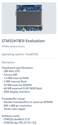

JohanAstrup
New versions of both the STM32H7B3I-EVAL TBS and BSD, which support newer board revisions, have now been uploaded to TouchGFX Designer.
The new TBS version is 3.0.21, and the new BSD version is 3.0.18.
Best regards,
Johan
Since the memory questions are unrelated to the topic of this thread, I would recommend creating a new ticket for clarity and visibility.
However, to answer briefly, I would first recommend reviewing the description of the TBS available in TouchGFX Designer. From there, you can see which memories are initialized and used in the TBS. As shown, the SDRAM is e.g. used for the framebuffers:
As a next step, you can review the map file to see what goes where.
I would also recommend reviewing at least this article in the TouchGFX Documentation: https://support.touchgfx.com/docs/basic-concepts/framebuffer
Best regards,
Johan
