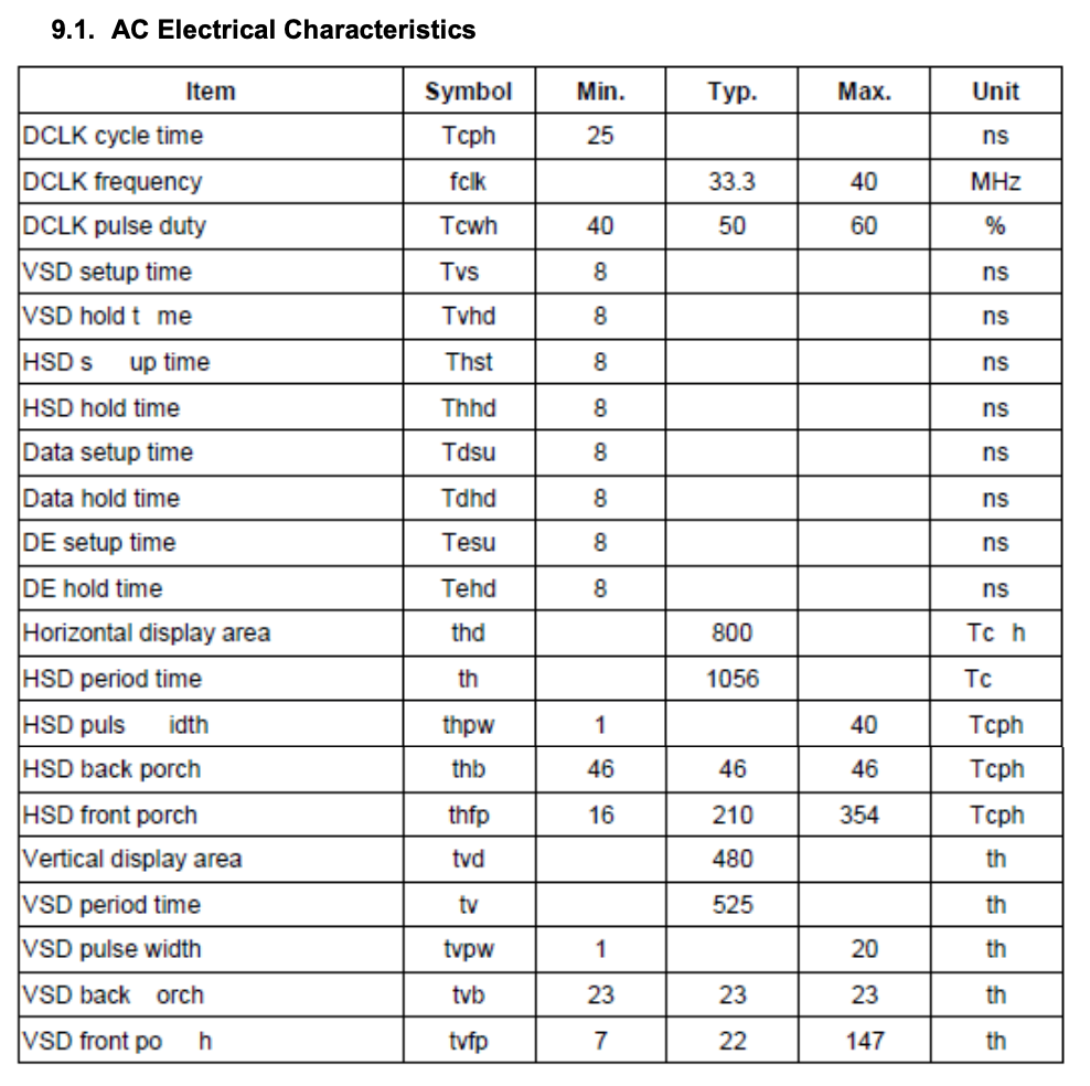

I am using STM32F767 to control RGB TFT LCD. Data is output on the screen with TouchGFX.
But sometimes the screen momentarily breaks for a very short period of time and then comes back.
When I changed the porch value of LTDC, the cycle of symptoms changed.
0693W000005ABMNQA4.pngThe following is the data on the Porch of my LCD. How to change LTDC's Porch value?
current LCD Clock is 32 Mhz.

"The cycle of symptoms" changed to what?
Looks like your configuration is according to spec - Have you tried changing T080800480_A1TMN_003_VSYNC within that allowed range (1-20) - currently 2.

I found the rendering time to be lacking.
In Model::tick(), it was confirmed that the data is constantly being updated. By changing this to an appropriate level, all problems were solved.
