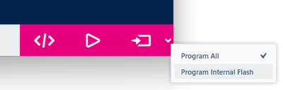

Hello @farukisiker ,
I'm joining @ferro and @Pavel A. on the idea of updating only the area that is actually changing. If you look at our TBS, we put all our application code in internal flash but the assets are in external flash. Then in the designer, when we need to run the application on target, we can select to flash only the internal flash (if the assets haven't changed), that way we gain a lot of time in development process.
