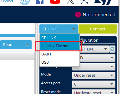

Hello @gatadivijay ,
But STM32CubeProgrammer supports also J-LINK:
Did you try the same steps with this config?

‎2024-10-28 5:45 AM
‎2024-10-28 5:49 AM
I can able to program with J-Link Flasher.
But Product State how can I implement on J-Link Flasher??

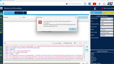

‎2024-10-28 8:11 AM
When I try this I got below issue. How can I resolve this.
