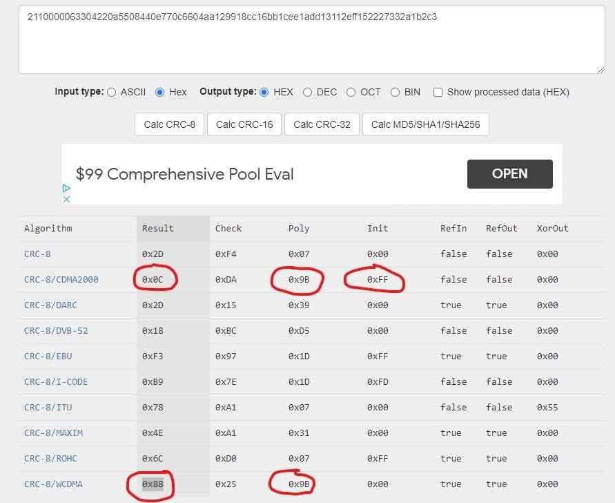

I need CRC8 in my design. Thinking with the Polynomial programmability in Stm32G4 . It should be straight forward.
When I tried to test with the example "CRC_UserDefinedPolynomial" coming with stm32cube_fw_g4_v130 in "Examples_LL" folder, the result (0xA6) matches the "expected value" set in the code.
However, when the same group of the data is tested with other CRC calculator for Poly 0x9B, eg. https://crccalc.com/, the result is 0x88 instead of 0xA6.

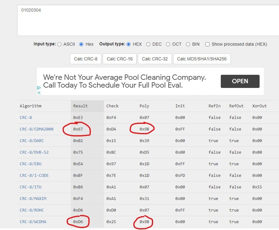

Then I tried another example (different data set 0x1, 0x2, 0x3, 0x4) with HAL, the result doesn't match either.
The CRC hardware is a blackbox so I couldn't figure it out why. Is there anyone having running into similar issue and knowing the cause of the mismatch?

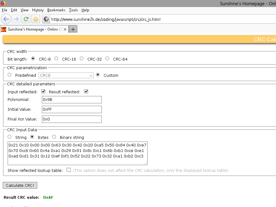

I tried both http://www.sunshine2k.de/coding/javascript/crc/crc_js.html and https://crccalc.com/. These two match well.
Then I tried various Input/Output Reflect (Reverse or Non-reverse), Initial value(0x0 or 0xFF). So far, none match the result from above sites.
Maybe only ST guys with internal info can solve the puzzle. It's from their example, wonder how they verified the result.
