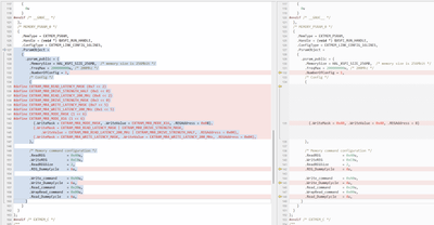

In STM32Cube_FW_H7RS_V1.3.0, file Projects\STM32H7S78-DK\Applications\ROT\OEMiROT_Boot\Inc\stm32_extmem_conf.h:
The configuration for the external RAM (presumably for an APS256XXN-OBR-BG, since that's what on the DK) is incorrect. In particular, it doesn't set the latency values to be able to run at 200 MHz.
(I think that the dummy cycle values may also be wrong - but I suspect they're ignored anyway.)
Here's my code (I also changed the drive strength, but that may not be necessary). Without these changes, the RAM could be read, but not written:

and as a diff:

Hi @Steve Melnikoff ,
Your feedback is shared with development team and should be considered in future deliveries.
Internal ticket number: CDM0059390.
