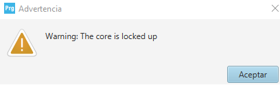

i have a similar problem
when trying to flash with stm32cubemx gui some bins
i get the same :0693W000007ExAkQAK.png

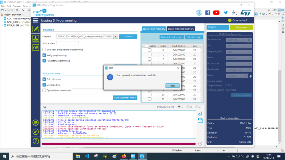

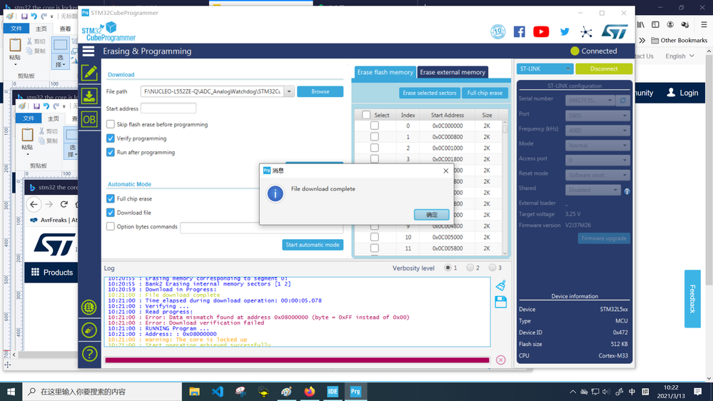

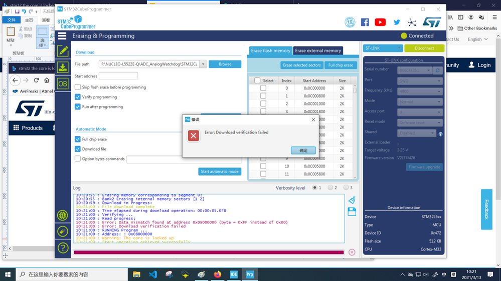

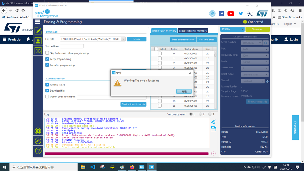

PCROP, where is it? I got the same problem:

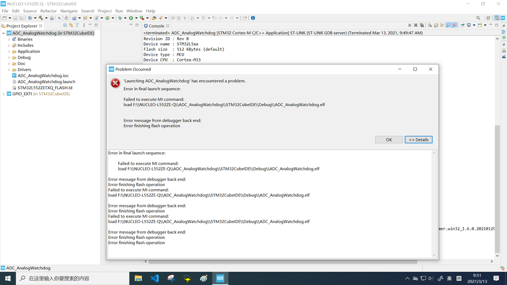

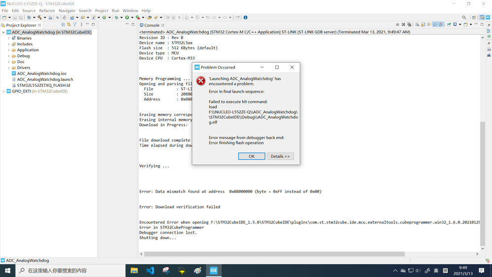

0693W000008woWAQAY.png0693W000008woWFQAY.png0693W000008woWKQAY.png0693W000008woWZQAY.pngactually, I met this issue because when I run in STM32CubeIDE, it couldn't download code into the board:

My solution:
  1. plug out, wait a little time, plug in, then reprogramming.
  2. alternately programming by CubeIDE and CubeProg.
