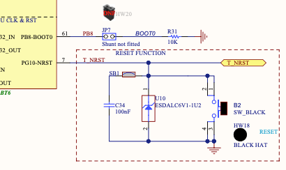

I've attached my schematic.
Check your BOOT pin. It's floating.

Yes, I considered the boot0 pin - but it is also floating in the NUCLEO board

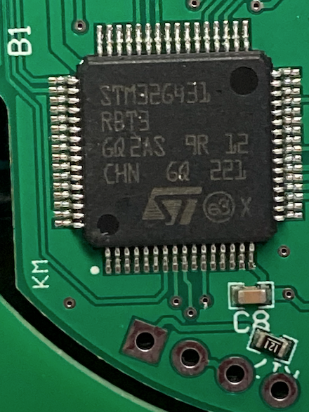

I'm beginning to suspect faulty or damaged chips. They were assembled by a reputable PCB firm in China.
I'm very careful with ESD using an ESD mat on the workbench, and proper ESD wrist straps etc.
I think I will transplant the STM32 from the nucleo board onto my board and see if the problem persists or goes away.
So I have 10 of these prototype boards, and so I pulled out a brand new one, programmed it with the project and it worked... kindof.
If I start the project with the dbugger attached using the RUN button then it works fine. All the timers and UART etc are doing there thing.
But if I disconnect the programmer and reboot - it hangs at the first call to HAL_Delay. So something is causing the system timer not to start. I cannot find out what it is. I've checked all the VSS and VDD pins, all are good, VDD is 3.3 V and nice and clean. Reset signal is present and correct. If I manually reset (by taking NRST pin to gnd,) I get the same symptoms. I tried adding __enable_irq() but it made no difference at all. The chip looks genuine.

Feels like a floating BOOT0 pin would explain the general behavior.
Yes maybe, but the NUCLEO boards do have this pin floating. Also, if BOOT0 was to blame, it would be booting from SRAM which would not run Main and I wouldn't see my PWM on the oscilloscpe.
However, to be sure I will tie the BOOT0 pin to GND and see what happens.
In most STM32 BOOT0 is it's own pin, here it shares functionality with PB8
Check that their aren't Option Byte settings to perform an equivalent function, ie boot into user flash by default.
