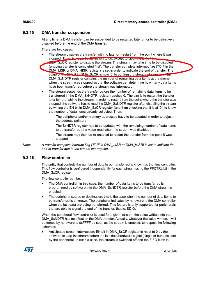

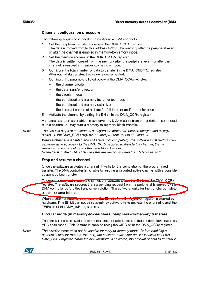

I know this behavior is true for the particular F4's and F7's I have used but is it true for the L42x? Because I am not seeing any DMA interrupt triggered by disabling "DMA_CCR_EN" on my chip.
And how does one know if this behaviour is enabled or not or where is it more clearly documented?

There are two different DMA designs in the STM32s: single-port in 'F1/'F0/'F3/'Lx and dual-port with FIFO in 'F2/'F4/'F7.
> This behavior is not mentioned in the Reference manual
For the dual-port DMA, it *is* documented in RMs, e.g. for 'F446:
0693W000004JxpMQAS.pngIt's described also in the related AN4031, in 4.1 Software sequence to disable DMA (although with a confusing "In both cases" in a chapter describing one case... ST's documentation is not famous for being precise.).
The single-port DMA has only a very confused description of the disabling process, e.g.
0693W000004JxtOQAS.png The related AN2548 does not mention channel disable.
If you don't see the interrupt upon channel abort, you have to "help" it: set some volatile variable indicating "aborted transfer" to the DMA ISR, and then force the DMA ISR using the CMSIS intrinsic NVIC_SetPendingIRQ().
