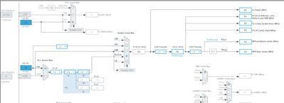

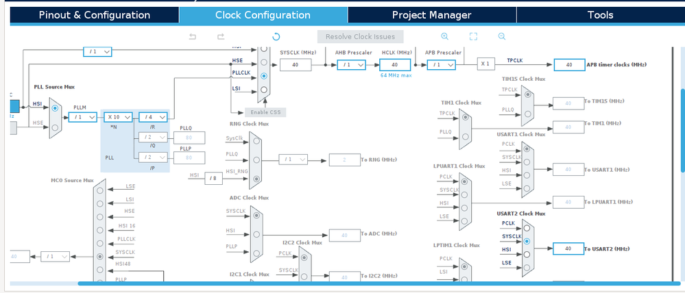

I am using stm32g0c1ret6 MCU board with 40 Mhz for now, to get accurate 2.5Mbps baud rate. but my actual application is on 64Mhz.  i have attached the system clock settings and clock config snapshot for reference.

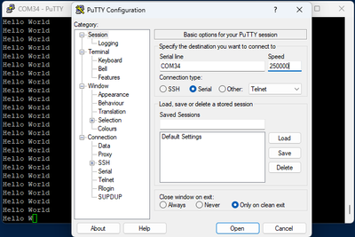

because I tried replicating your case and honestly, I didn't encounter any issue
it worked fine. So, can you provide more details?

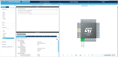

I'm going to attach some screenshots if you want to compare with your own project or maybe if you want to replicate it.

@Gyessine   Thank you for reply.
I am using the stm32G0C1RET6 board it is a ST EVK board and the supports the UART comm upto 8Mbps.
i have connected the UART-to-USB TTL to USART2 of this MCU and tried communicating using the Minicom as a serial terminal with Baud rate - 2500000 (you have given one less zero).
