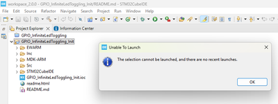

Unfortunately, I got to step 5 and found that the instructions diverge from reality.
They never said to click Finish to complete the Import Projects dialog.  And there is no way to select the project they mention from it.  But if I click Finish, then a tiny icon appears on the upper left.  If I click it, then there is a Project Explorer window.
The next step is:
My IDE has no Debug icon (the the little yellow blob on its lower left).  But it does have a Debug As icon.  Clicking that one results in:
So now I'm stuck.
Any help would be greatly appreciated!

KnarfB
"The selection cannot be launched..." refers to the selection in the Project Explorer View. Make sure that the project icon of the project you want to debug is selected.

The project was indeed selected.
So it seems that was not the issue.

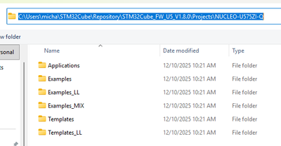

As the installation steps suggest, I got the example from STM32CubeMX:
All the examples then showed up here:
The tools installation steps suggest that one should be able to simply click "Debug" and run the example on the device (assuming driver installation succeeded).
Should I not expect the installation documentation to be true?

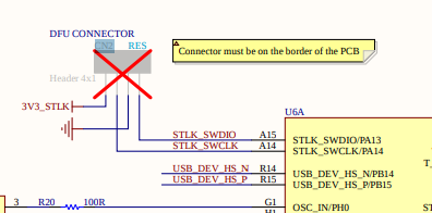

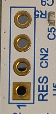

BTW, the instructions say:
But on my board, the CN2 header is not populated:
And there are four leads!  What should be jumpered to what?
The board documentation (um2861) makes no mention of it.
Thanks.
Mike
right, see circuit of board:
https://www.st.com/resource/en/schematic_pack/mb1549-u575ziq-c05-schematic.pdf
its for programming the st-linl itself - you should never need it.
