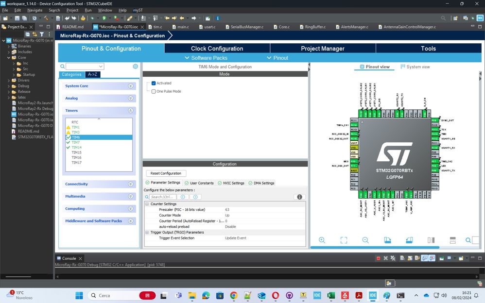

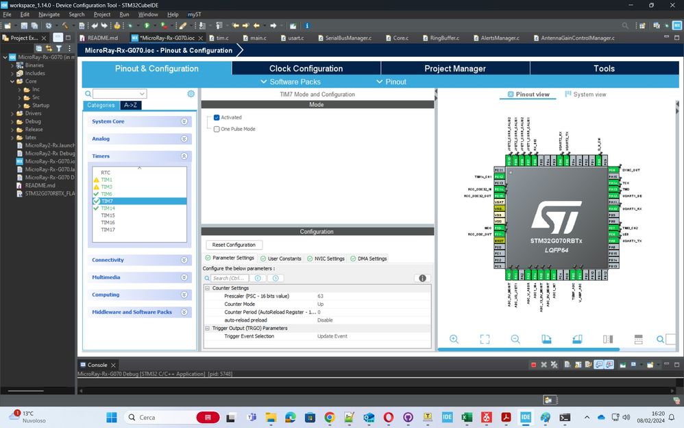

I added TIM7 to application and configured it the same way TIM6 was.
I need to use two timers for my app, code contains all the same setups for TIM6 and TIM7, except for the timer expiration counters, and I observe that the callback
void HAL_TIM_PeriodElapsedCallback(TIM_HandleTypeDef *htim)
never enters in the conditional block it contains:
if ( htim == &htim7 )
/* code block */
the callback above is invoked when htim == &tim6.
The timers setup are:tim6.jpgtim7.jpg
Please help, I double checked all I could without finding a solution

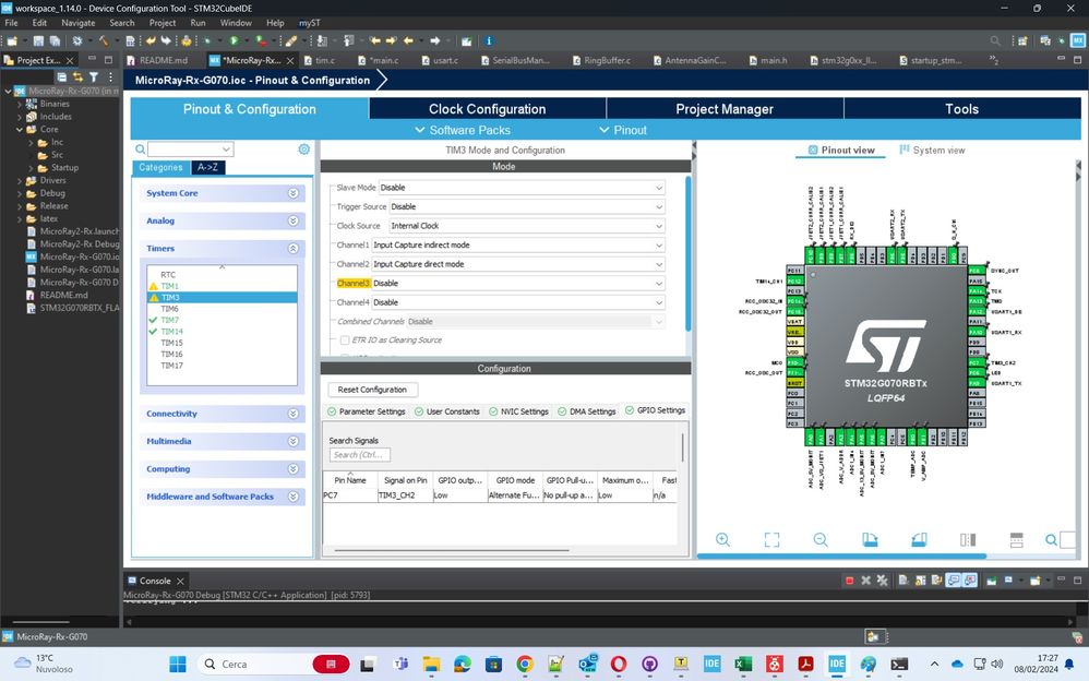

tim3.jpgHi,
the app works correctly with timers TIM3, TIM6, TIM14 together. I add TIM7 and TIM7 doesn't work as expected no matter if TIM6 is present or not. TIM14 used for PWM generation does not fire callback above. TIM3 has 2 channels for input capture and it fires the callback that does nothing with TIM3.
Could you please keep only TIM6 and TIM7 firing the interrupts just for the test?
Have you enabled the timers' interrupts? I can't see it on the screens you supplied.
