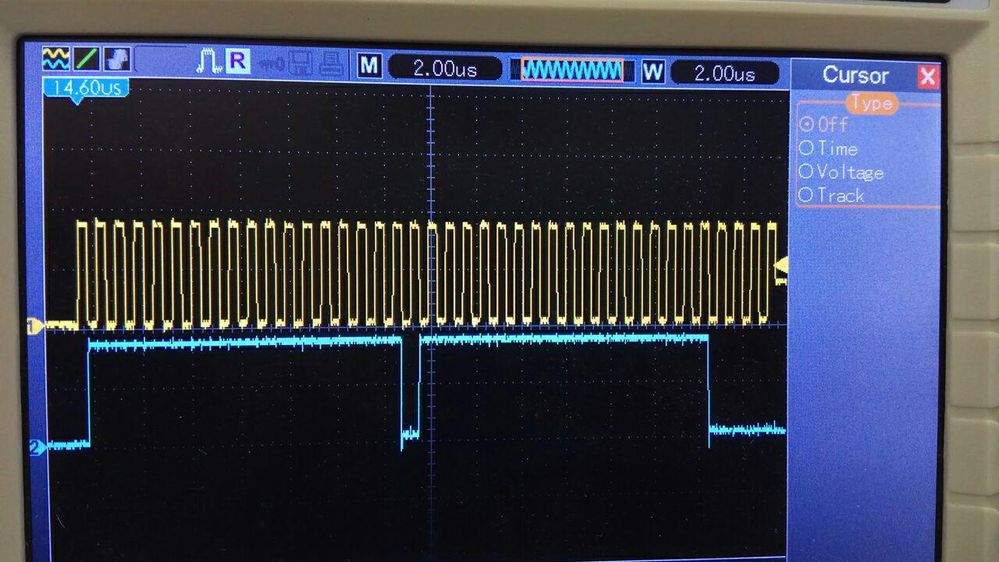

I use STM32F401CBU6 with two AD7690 in chain mode (Page 21:
http://www.analog.com/media/en/technical-documentation/data-sheets/AD76pdf
I connected IN AD7690 to VREF.
The oscilloscope I get 11111111 11111111 10111111 11111111 11100000
But in spiData I get 11111111 11011111 11111111 01111111 11110000
uint64 spiData;
while(1) {
spiData = 0;
HAL_GPIO_WritePin(GPIOA, SENSOR_ADC_CVN_Pin, GPIO_PIN_SET);
while(HAL_GPIO_ReadPin(GPIOB, SENSOR_ADC_MISO_Pin) == GPIO_PIN_SET);
HAL_SPI_Receive(&Peripheral::spi1, (uint8*)&spiData, 5, 1000);
HAL_GPIO_WritePin(GPIOA, SENSOR_ADC_CVN_Pin, GPIO_PIN_RESET);
HAL_Delay(150);
/* SPI1 init function */
void Peripheral::InitSpi1() {
spi1.Instance = SPI1;
spi1.Init.Mode = SPI_MODE_MASTER;
spi1.Init.Direction = SPI_DIRECTION_2LINES_RXONLY;
spi1.Init.DataSize = SPI_DATASIZE_8BIT;
spi1.Init.CLKPolarity = SPI_POLARITY_LOW;
spi1.Init.CLKPhase = SPI_PHASE_1EDGE;
spi1.Init.NSS = SPI_NSS_SOFT;
spi1.Init.BaudRatePrescaler = SPI_BAUDRATEPRESCALER_64;
spi1.Init.FirstBit = SPI_FIRSTBIT_MSB;
spi1.Init.TIMode = SPI_TIMODE_DISABLE;
spi1.Init.CRCCalculation = SPI_CRCCALCULATION_DISABLE;
spi1.Init.CRCPolynomial = 7;
if(HAL_SPI_Init(&spi1) != HAL_OK) {
CriticalError();
What could be the matter? Why is this happening?
