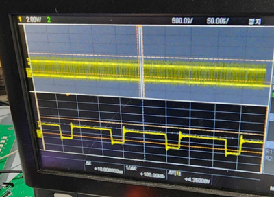

The PWM signal that has passed through the level shifter(level converter) is not clear.
‎2024-05-21 12:40 AM - edited ‎2024-05-21 12:41 AM
I'm using PWM with level shifter(BSS138, 74HCT14D, TXB0104) for developing IC embedded LED (such as WS2812)
However, when I captured this siganl using scope, I found that the signal was not clear.
Below are the pictures that I captured.
1. Before addition of level shifter
2. After additon FET level Shifter

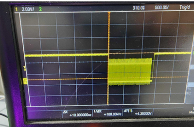

3. 74HCT14 Level shifter

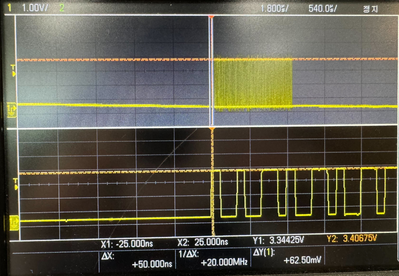

4. IC Level shifter (TXB0104)

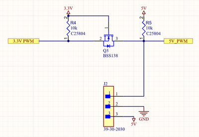

Q1
One thing I curious about is that why IDEL signal is in High instead of LOW when using FET level Shifter?
When I tested FET level shifter using non-STM32(ESP32), the Idle signal was LOW, not Hi. It is a very weired situtation!

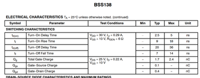

Q2
And also, according to BSS138 datasheet, T_rising is 18ns. However, in my case, It was longer than specification.

‎2024-05-21 4:37 AM
I would like to welcome you to the world of high frequency electronics. Even though you don't work with that high of frequencies.
Oscillations caused by impedance mismatch can be seen during polarity transitions.
To reach the values ​​in the datasheet, you need to make the connection via impedance-controlled paths.

‎2024-05-21 5:37 AM
Maybe G-S puzzeled . :) (or just wrong connected.)
see ds ... at 290mA + 6 ohm drive !
But you drive (3V /10k -> ) 0.3 mA , so mosfet + stray capacities dominate at so low current.
Why not using HCT gate as level shifter ? I use e.g. 74AHCT1G86 for such , ( xor, so 2. in on gnd, -> non inverting).
‎2024-05-29 5:19 AM
Thank you so much.
As you told me, It was a kind of impedance mating problem
So, My colleague and I changed the register's value and added some L and C. After that, It worked and published clean PWM signals which have definitely 5V in level after passing the shifer module.
