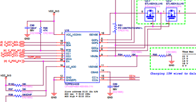

Hello Expert,
Could you please provide guidance on the issue below?
We are using the following setup:
- MCU: STM32G0B1CCTx
- Software: X-CUBE-TCPP 4.2.0 with USBPD Application 4.2.0 Dual Role
- Board Part: TCPP0203 v1.2.3
We are developing a USB PD board.
When we plug in an Android smartphone (USB Type-C port), the phone does not detect the connection.
Attached is the log showing three plug-in/plug-out attempts.(we plug in and out 3 times)
From the log, it appears that after attachment, the connection detaches immediately, then the roles switch, followed by another detachment.
We have already tried increasing the CAD source/sink toggle time from 100 ms to 144 ms, but the issue persists.
Could you advise on possible causes or solutions? Thanks.

Hello @PaulMinh
Did you implement the user code provided in this example? Would you share minimum schematics with USB C connector? Compare with reference board design to narrow down the issue.

PaulMinh
Hello FBL,
We followed https://www.youtube.com/watch?v=mJ4VX_2B6wE&t=839s , for our custom board (configured as in  MX_Config.PNG, SCH.pdf).

FBL
Hi @PaulMinh
Sorry for my late reply. Your schematics attached are pixelated and hard to read.
I see RS4 (~39 kΩ, check your exact value not clear) between VBUS and VSENSE. If the value between VBUS and VSENSE is too large or is not as per reference schematics (2–5 kΩ ), the TCPP03 can misread VBUS level.
About attach sometimes works only when plug/unplug is very fast. And when it does work, PD controller goes up to PE_SRC_SEND_CAPABILITIES, then you see a Hard Reset.
Would you
  • Probe: CC1, CC2, VBUS at the connector, and one TCPP03 gate/fault signal.
  • Check whether CC1/CC2 stay in a valid attach window for ≈100 ms, and whether VBUS ramps cleanly or shows a drop/overshoot around the timestamp of DETACH_SRC?
