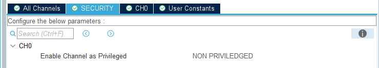

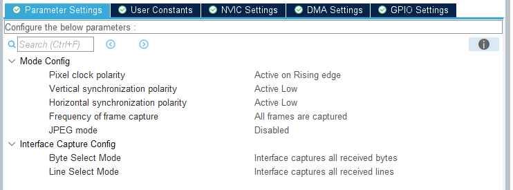

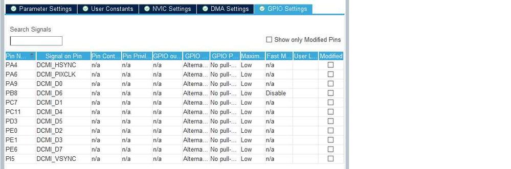

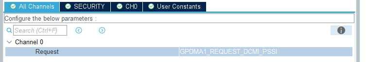

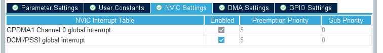

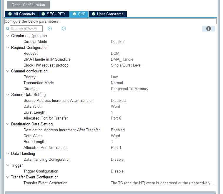

Attaching here snaps of the configurations we made so far.
DCMI GPIODCMI GPIO
DCMI NVICDCMI NVICDCMI parametersDCMI parametersGPDMA1 channelsGPDMA1 channelsGPDMA1 CH0GPDMA1 CH0GPDMA1 securityGPDMA1 security

This is for reference:

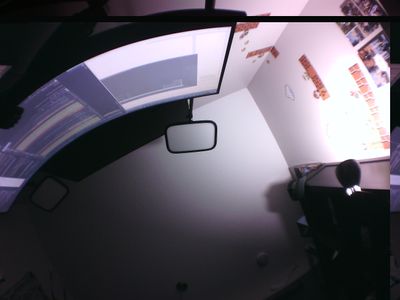

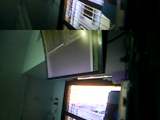

Update:
    I can now capture frames. But there is a problem, the frame get's splitted in the buffer. The scenario looks like a horizontal part from lower part of the frame is placed at upper position.
SampleSample

Thank you for your suggestions. I can't reduce the DCMI_PIXCLK, which is running at 12MHz right now. As I can remember, current DCMI_PIXCLK is well under DCMI spec.
I've found that the DCMI is filling the buffer assuming the frame as square,i.e. the current WIDTH x HEIGHT = 320 x 240 but the DCMI assumes frame of 320 x320.
If I provide a 320 x 320 compatible buffer, the DCMI is collecting the frame but the top 80 lines are blank(black) and I get the actual image as 320 x 240.

For this resolution, I recommend you to enable the GPDMA circular mode.
Please  let me know if the issue is solved or not?
Thank you.
Kaouthar
GPDMA is in circular mode. Yet producing the result.
ksid
We are experiencing a similar issue using HAL_DCMI_Start_DMA. Have configured a two node linked list in circular mode (SetCircularModeConfig) for DMA with an OV5640 in JPEG mode at full resolution. Here is an example image frame captured. Notice the horizontal issue at the top as well as along the right edge.
Investigation shows that the DMA is filling the target PSRAM memory buffer with a large gap at the start (explains the top black horizontal line). We ended up switching to manually controlling the ping-pong buffer using the XferCpltCallback directly on the DMA_HandleDefType object and managing the buffers ourselves. All worked fine after that. Is there possibly a bug in how HAL_DCMI_Start_DMA handles the ping-pong buffers?
