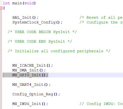

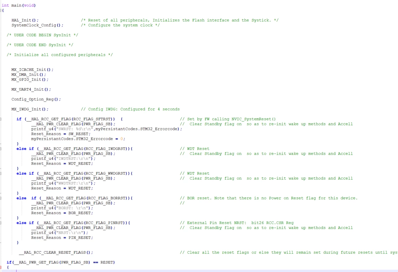

here is snippet of the init from reset:
December 10, 2022
You set IWDG for 4s and you see an event every 4s. It seems likely that’s the cause of the event.
Nothing on this chip can disconnect NRST. That’s hardwired.
From you code, looks like you have persistent memory. Perhaps this is getting into a bad state and causing issues during startup. That would explain things.
To definitely see if the chip resets you could toggle a GPIO immediately upon reset within the startup code using direct register access.

In my startup code, I initialize 3 uarts, an SPI bus (to read an external flash chip) and an I2C device.
When the chip locks up (which is only once in a while) I see the nRST pulses, but no other activity at all on any other io. When locked, the current consumption seems higher than the normal run. (i am clocking all the main busses at 16MHz using the HSI)
And what is odd is that some pins are set as output high, conflicting with that set by MX_GPIO_Init();
This is what is leading me to think that PC is vectoring to some other block of code upon reset.
But i will try blipping an LED using direct port access, not using HAL.

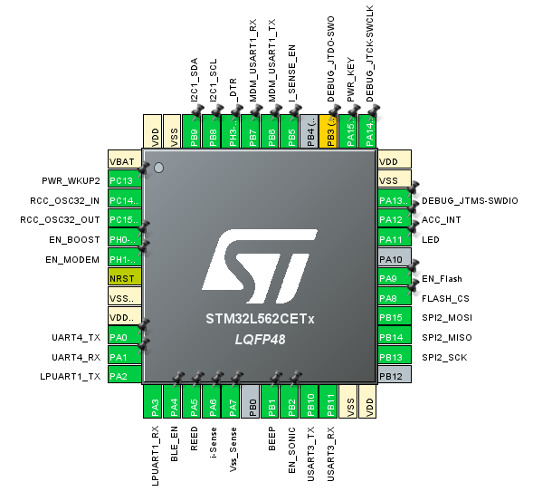

0693W00000WKirMQAT.pngIt it possible for MX_GPIO_Init(); to lockup or fail in some way?
I ask this because when we find a unit that has locked up, I probe the pins and observe the following:
nRST H, -ve pulses every 4 seconds.
32kHz LSE crystal Buzzing ok.
All other pins static
PC13 Output High (WKUP2)
PB10 Output High
PA4 Output High
PA5 Low
This conflicts with how MX_GPIO_Init(); configures the above.
The only pin that should be high, is PA5, which is configured as an gpio input, with pull-up.
Other pins are configured as communication ports.
Attached is MX_GPIO_Init(); Its simple enough.
