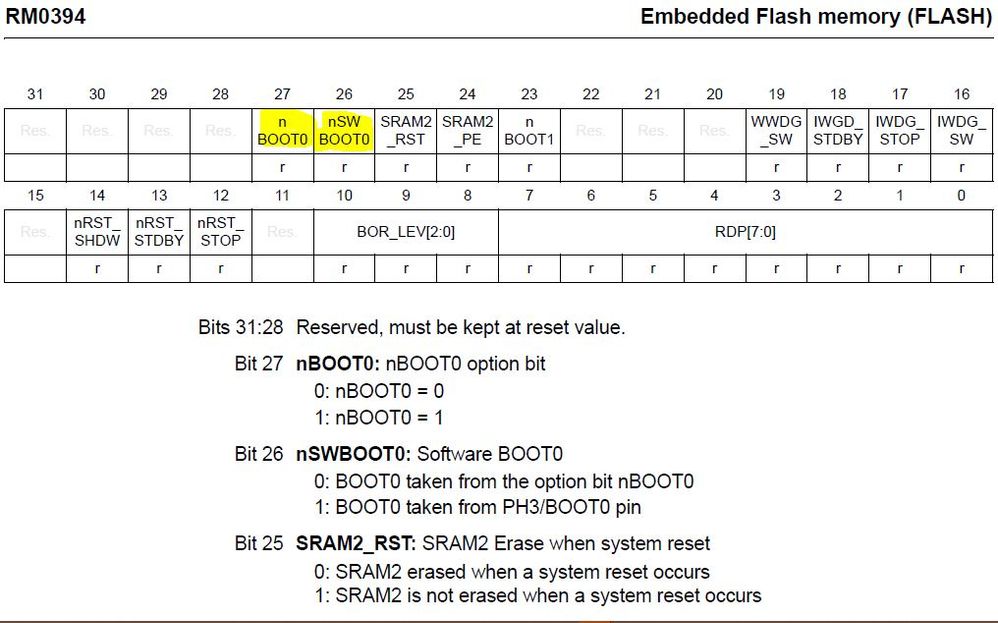

Hello
Take a look with STLink utility or CUBEProgrammer to nBOOT0 and nSWBOOT0 option bits. To be able to control BOOT0 functionality from BOOT0 pin, nSWBOOT0 option bit must be "1" .
yup. that's supposed to be the default, the way they are configured in the factory. And that's what I see in my device.
