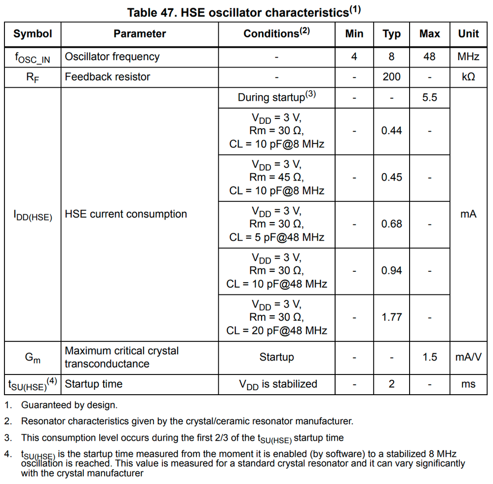

Hello, I design a device, based on STM32L475RE MCU
and my goal is to minimize the power consumption.
Peripheral I use :
  • 3 sensors(accelerometer, temperature, humidity) and external RTC(M41T64Q6F) on I2C bus
  • External flash on SPI
  • USB
  • ADC to read battery level

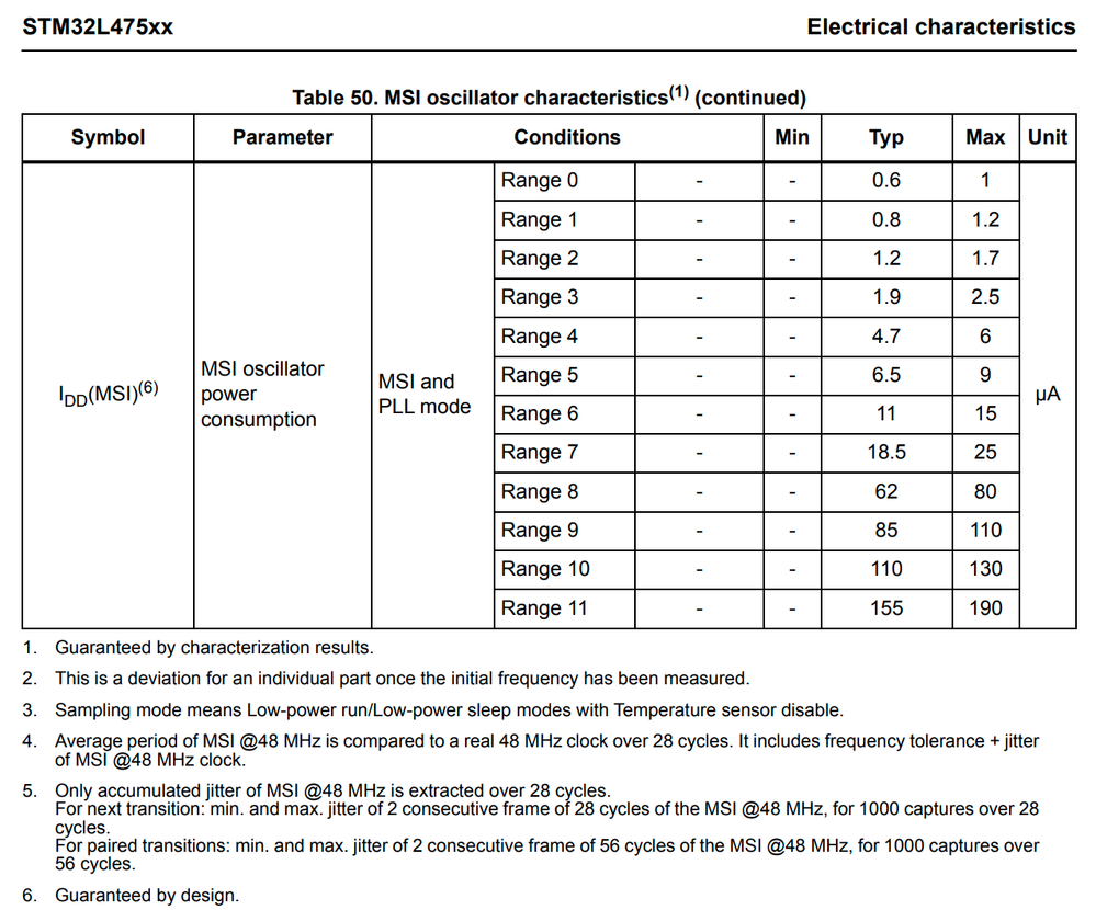

  1. Would it be better for power consumption to change HSE for MSI, and is it reliable for peripheral I use to work with MSI?
  2. USB is needed really rarely, so is it possible to initialize USB when connected and does it make sense?
  3. How to know that USB is connected?
4 replies
October 11, 2021
The datasheet includes detailed breakdown of current consumption by MSI and HSE. In general, MSI uses less power.
The L475 supports crystal-less USB, but requires an LSE to do so. No other peripheral that you're using needs precise timing.
Makes sense to me.
Connect VBUS to a pin (preferably with resistor divider), and monitor it.
