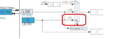

I have designed a custom PCB using the STM32L031K6 microcontroller. The board includes an external 32.768 kHz crystal oscillator (LSE - Low Speed External).
The Problem:
I am flashing code to the board using an ST-Link. When running a simple LED blinking application (which uses HAL_Delay), the LED either blinks only once or gets stuck indefinitely within the HAL_Delay function. This strongly suggests an issue with the microcontroller's clock configuration or the LSE activation.

Hello @cekz and welcome to the ST community,
So why are you suspecting a LSE issue while HAL_Delay() is based on either a timer or system tick counting?
Peter BENSCH
…and why are you selecting LSI instead of the LSE?
That's one more reason indicating it's not a LSE issue.. it's something else..

I measured the oscillator with an oscilloscope and could not get a proper signal.
Which oscillator ? LSE?
This is definitely not a LSE issue as you are reaching the while loop.
And here, LSI is selected and not LSE:
STM32CubeIDE does not allow me to select LSE. I cannot make any settings in that section.

Here's how I solved the issue;
On the STM32L031K6, I couldn't select LSE directly in the Clock Configuration. After enabling RTC Active Clock Source under the "Timers" section, the LSE option became available.
