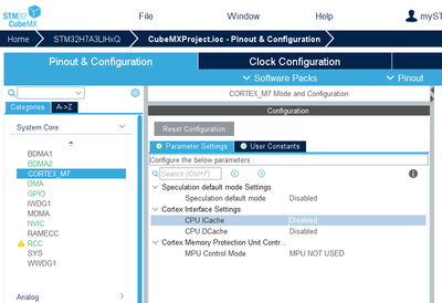

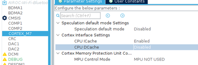

D-cache should not make things more difficult , so i recommend to not use it.
Just in Cube do not enable it, later can enable and do the cache management - was my idea, to make it more easy.

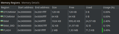

And after mod the xxx_flash.ld file you see it is used ? ->
Now it should work.   8)

H7A3 has D-cache - how you manage this /with dma ? (see nothing in your text)
Simple solution: switch off (or not enable) D-cache . (NOW ! if bdma working...can work on this, cache management.)

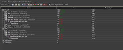

@AScha.3 That helps a lot but I'm not there yet.  I modified my test code to look like this:
//Per the reference manual (RM0455), BDMA only has access to SRD ram section
__attribute__((section(".RAM_SRD_section"))) ALIGN_32BYTES(std::uint8_t  getFPCmd[]) = "abcdefghijklmnopqrstuvwxyz";

VisualGDB has a nice embedded memory explorer and here's what it shows.
Both DCache and ICache were already disabled in CubeMX so that probably wasn't my issue.
At this point I think the problem may be in my code that sets up the LPUART and BDMA and tries to transmit my message.  So I'm going to triple check what's going on there.
Thanks again for all the help

ALIGN(32) is just good - if you (later) want use d-cache , the address is matching the cache access (is 32 byte line).
( ALIGN(xx) is in bytes.)
I-cache you should enable, makes code faster and "produces" no difficult side effects.
