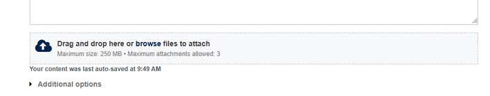

PS: avoid using Google drive to share a project but attach your project compressed by using drag and drop:
