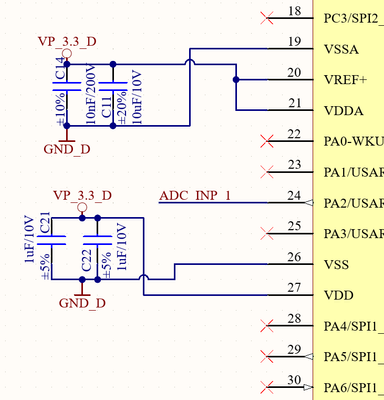

VSSA is to the same GND_D as VSS. Refer SCH below.

So GND_D is not digital ground, but also analog ground? I recommend filtering the analog power supply, filtering VREF+ and connecting the analog ground to digital ground on 1 spot. Right now both VDDA/VREF+ w.r.t. VSSA and VDD w.r.t VSS have the same ripple as they are in parallel.
I recommend not connecting the VREF+ to VDD.

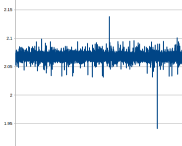

You said you see 1 V of noise, but the data you present shows around 0.01 V of noise.
@TDK 1V is considering those intermittent spikes with some earlier tests I did. At times the values shoot up or down. Below image shows that it is nearly of 0.1. And it is erratic. Need to get rid of that. What could be the possible reason?
I think we already concluded it's not the signal source. So it must be in the circuit and in the wiring.

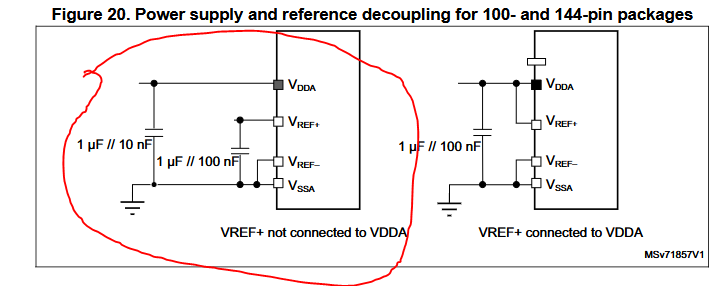

Any noise or ripple on the VREF+ will effect the measurement. You use an unfiltered power supply for VDDA and VREF+ and use long wires. I recommend filtering the analog power supply with a ferrite bead and a capacitor.

These are likely due to volatility in the VREF+ rail.
