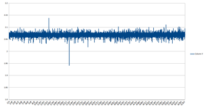

@unsigned_char_array @TDK @MasterT @Ozone @mƎALLEm
A few observations.
I monitored a 8.1V battery fed to the divider-buffer circuit. Below attached is the log plot.
What are the possible reasons for these spikes? If these are avoided, it will be great.
  • The wires are about 8-10cm in length, from buffer output to ADC pin.
Did you measure with an oscilloscope or is this data from the ADC? Without a comparison between actual voltage and ADC counts it's hard to know where the problem is.
Do the wires to VSSA and VADC form a loop? A buffer should have a low enough impedance so there shouldn't be too much signal picked up at 8-10cm wire length, but it is better to avoid any loops.
This data is from ADC. I checked the 8.1V battery output on oscilloscope and it had a ripple less than 10mV. Much better than a calibrator source or a standalone power supply that I checked (50mV, 700mV). This log was taken with the battery input.
VDDA, Vref+ are connected together on the PCB itself and they have an additional decoupling of 10nF and 10uF.
3.3V and GND are taken from the PCB using shortest possible length of wires on to the stripboard.
Good. Though I was hoping you checked on the ADC input with respect to ADC REF+ and VSSA.
Where have you connected VSSA?

10 cm of wires is too long ! Put a capacitor as close to uCPU as possible, in between AGND (analog ground plane) and ADC input. 0.1-1 uF, and if buffer OPA is in use, series resistance 10-50 Ohm from OPA output.
For battery measurements oversampling is the best way to do noise reduction.
