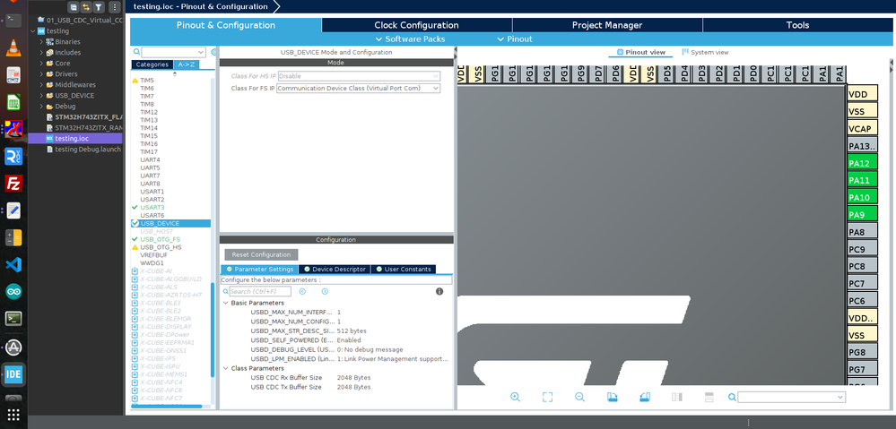

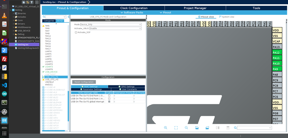

Dec 20, 2024 5:20 AM UTC

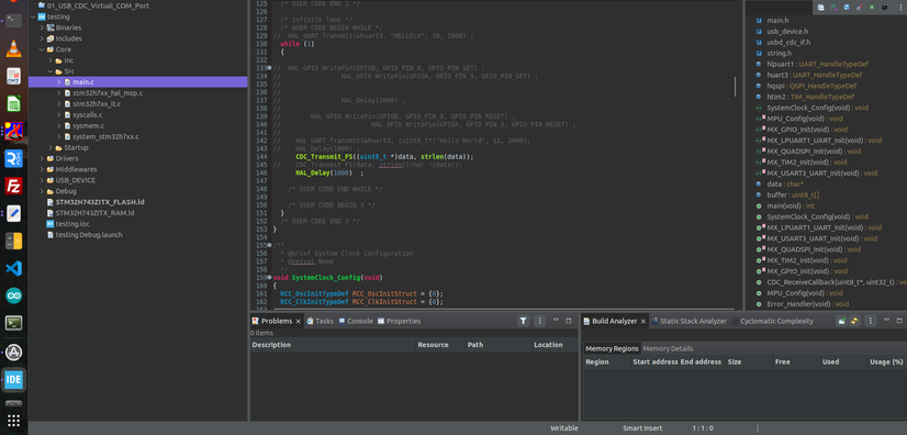

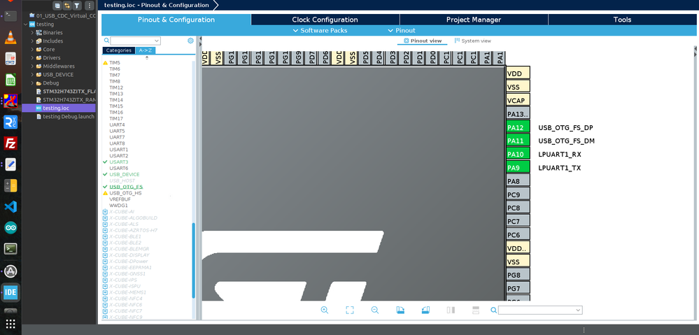

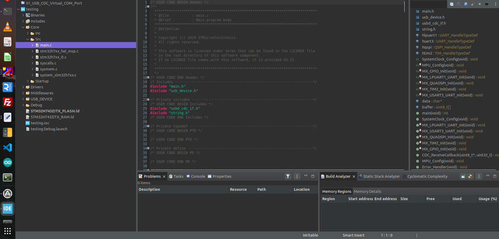

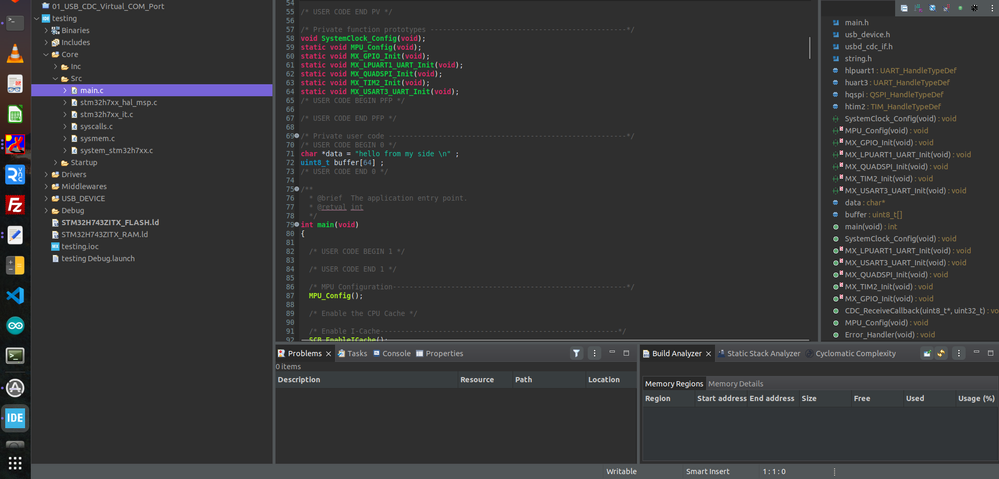

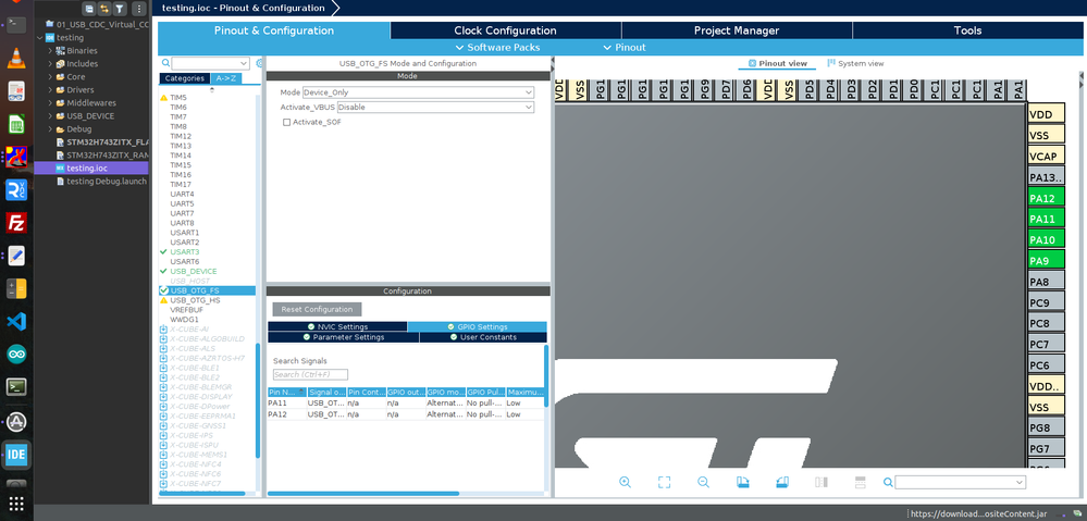

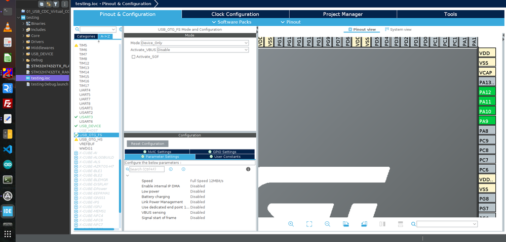

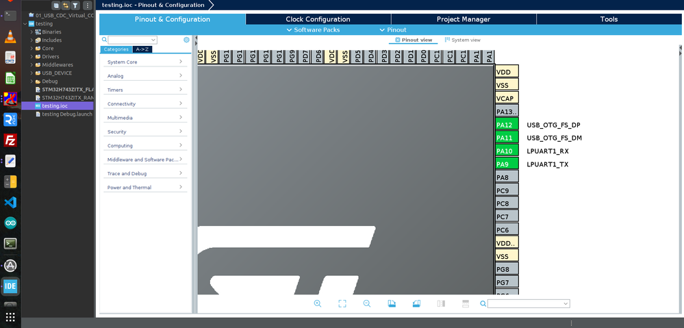

Screenshot from 2024-12-20 10-44-38.pngScreenshot from 2024-12-20 10-44-29.pngScreenshot from 2024-12-20 10-44-18.pngScreenshot from 2024-12-20 10-44-01.pngScreenshot from 2024-12-20 10-43-56.pngScreenshot from 2024-12-20 10-43-46.pngScreenshot from 2024-12-20 10-43-39.pngScreenshot from 2024-12-20 10-43-31.pngScreenshot from 2024-12-20 10-43-20.pngi used this configuration setup in ioc file and call the cdc transmit function in main.c but not working out , is this happening because of VBUS missing as mentioned above by rahu2710 , he is from hardware team , and i am from software team .
please help me .
Dec 20, 2024 1:25 PM UTC
> "not working out"
This is not a useful description of a problem. What behavior do you see? What behavior are you expecting? Have you done any debugging?
Consider working from a known good example, or using that as a base.
