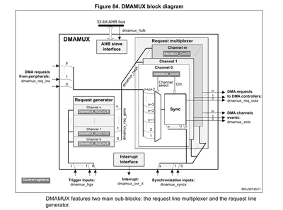

If your H7 can...read in rm of it :
-- could use the dmamux , H743 ->
-- in Cube see:
-- or use MDMA :

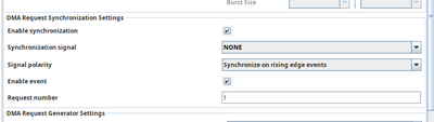

Hello
What effect does this Setting?
