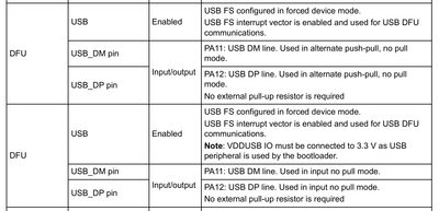

> Is this expected behavior for this device/package (no VBUS sense available to ROM)?
Yes. According to AN2606, there is no provision for reading VBUS before trying to connect with the USB DFU bootloader. Only the DM/DP pins are used.
> Is there any option-byte setting or ROM bootloader revision that defers the pull-up until VBUS is actually present (possibly via a GPIO)?
No.
> If not, what’s ST’s recommended workaround for self-powered designs on this package?
Don't use the system bootloader, or implement a hardware solution to prevent those lines being energized without VBUS.
