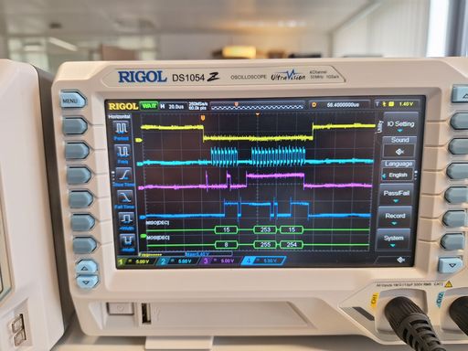

I'm currently working on a project where my STM32G747RE is acting as an SPI Slave.
The SPI transmission is as follow:
  1. Master sends 8 bits "command"
  2. Slave send back 16 bits "data"
My issue is the following; On the MISO line, the STM32 always send back the first 8 bits of data on the first 8 clock cycle of the next SPI transmission. The picture will clarify my words:
20240311_135956.jpgHere the following SPI transmission happends:
  1. Master sends on MOSI the command 8 (then the other 16 bits are 0xFFFF which is good)
  2. Slave sends on MISO the data 253 15 (and then on the first byte of the transmission it also sends 15)
The issue here is that on the MOSI we have 15 that is the data of the previous transmission.
From where can this come from and is there a way to put the SPI buffer (FIFO) high: 0xFF by default ?
Thanks for your support,

There is no setting for default value in the absence of new data. If you want MISO to be high or low, treat it as a normal data byte and write 0xFF or 0x00 to it on the slave side.
Usually these sorts of dummy bytes are specified as "don't care" in the datasheet and you shouldn't worry about how they appear.
SidiusAuthor
March 11, 2024
I can accept the idea behind "dummy bytes" but here we really want to control what is getting on the MISO line.
But on my setup the MISO line signal get through several drivers before ending to the master, that means that the signal can only go from the slave to the master. So that means that the slave is putting something on this line right ?
Because I don't really see why the master would drive the miso line...
Yes, the slave drives MISO.
SidiusAuthor
March 11, 2024
Alright, and about
"If you want MISO to be high or low, treat it as a normal data byte and write 0xFF or 0x00 to it on the slave side."
What should I do, modify the registers or config values of the SPI2 or just expanding my sbuffer_tx ???
March 11, 2024
Expand your buffer and change your program logic to deliberately send 0x00 or 0xFF on the first byte, if that is what you want.
SidiusAuthor
March 13, 2024
Actually, I discover that my SPI TX FIFO was outputting his value when I'm reading the first byte. That means I need to empty it or put 0xFF inside of it. One way to do it is:
HAL_SPI_Abort(&hspi2);
__HAL_RCC_SPI2_FORCE_RESET();
__HAL_RCC_SPI2_RELEASE_RESET();
But that is quite rough for the microcontroller I think, no ?
Is there a way to just change the value inside the SPI TX FIFO in a more gentle way ?
Thanks for your reply,
Sidius
