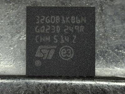

I have a request: as you probably are going to get the proper N-suffixed parts, once you get them, could you please post photo of them here, for others to have a reference?
Thanks,
@waclawek.jan, I've ordered a few of DigiKey to attempt swap the wrong one out. I should get some next week, and ill order a new set of boards but they'll arrive at least 6 weeks from now.
May I ask why you need photos of the IC markings?
To detect counterfeits?
Long story short:
I contacted the fab and they apologized and claimed that the N-variant was simply for the extended temperature range. A bit of back and forth with pictures and links to the datasheet pointing out that they were wrong. They did eventually offer to refund the order since it was a handful of simple prototype boards.
Not me personally.
It would benefit anybody who comes across the same problem as you in the future.
The point is to highlight the differences in the marking. I know, the marking changes, but generally, the differences should hopefully stay roughly the same.
Here's the requested image of the STM32G0B1KBU6N.
I think the issue is not that i didn't know what the IC markings would look like but rather that it never crossed my mind that the fab would place the incorrect processor on such a simple board.
waclawek.jan
Thanks.
OK so they omitted the "package type" letter (U) to fit in the "extra" "N".
That's not exactly expected and IMO this ought to be documented in the DS and/or TN1433, preferrably both.

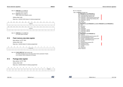

PS. Once one knows what to look for, the distinction between non-suffixed and N-suffixed part can be found out also by reading the device's signature, maybe even CubeProgrammer supports this?
The mess this issue is can be seen also in how the suffixed/non-suffixed disctinction is marked as "Power Delivery" and "N-version" in various models, within the same page. ST, it's you who invent the nomenclature, please strive for consistency.
I've also experienced lackluster documentation, especially from the HAL or other tools.

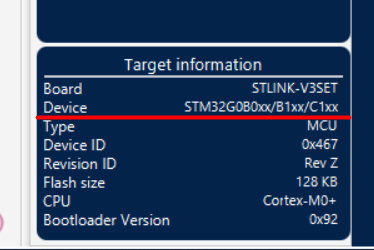

I quickly tried to read the Package data register from CubeProgrammer but I can't seem to read any register below 0xE000ED04.
It would be a nice feature to add to CubeProgrammer since one of the first things I looked for was the device ID and type. I don't think that there is a way to know exactly what variant is used (other than looking at the UUID and referencing a database). At least they could add the Device electronic signature register to the register menu.
