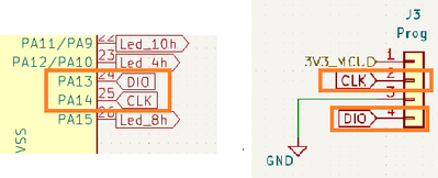

i'm trying to read the G030 mcu (from my PCB) with cubeProgrammer and the results are:
"No STM32 target found! If your product embeds Debug Authentication, please perform a discovery using Debug Authentication"

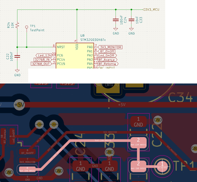

Today the debug pins are direct connection (without any pull-up or down), as show:
But I already tried to pull-down (and pull-up) the SWCLK pin (as shared with BOOT0). but no way to recognize te MCU.

the NRST voltage is arround 0.7 (i think it's not good because another MCUs that i have checked here is close to 3.3V)
the HW and SCH was OK. i'm checking now the soldering process
Suggestive that the POR is clamping due to absent analogue supply
Doesn't NRST staying low contradict this? Might be worth another look. Issue has to be somewhere.
HW and SCH OK, i mean, the design it's OK (image below)
for sure, i have investigating another variant things, such as solder and now, the MCU origin (from suspicious vendor)
O, yes, the existence of R24 totally confirms it. Edited by moderators to adhere to community guidelines.
sorry i did not understood u.. this is my practice to use pull-up (if need it, i saw that G030 did not require but i design anyway) on NRST... what do u mean?
WHY exactly did you do it? It's a simple question, what do you not understand there?
