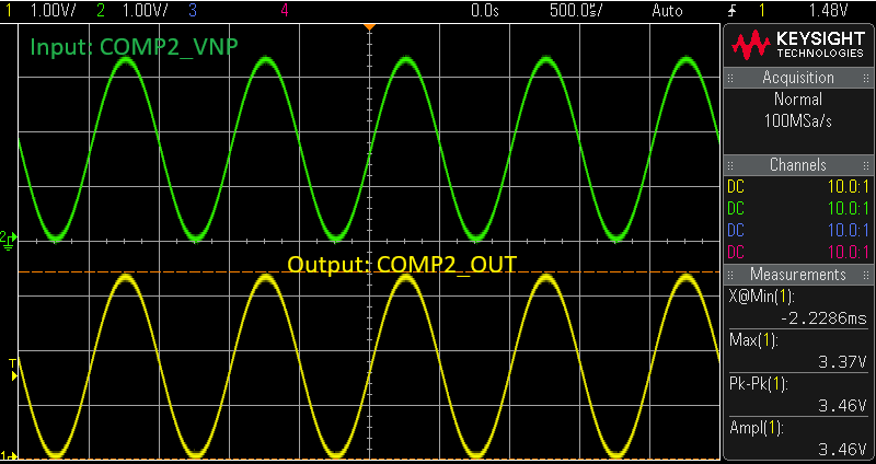

What voltage are you testing? are you injecting an external voltage for that Follower config? note that there is a LED connected on PB0 (OPAMP1_VINP) on STM32F753ZI Nucleo board.
So try with OPAMP2.
I've tested with OPAMP2 and I had almost the full rail-to-rail output:COMP2.png
Edit: In the screen shot, I meant OPAMP2 not COMP2

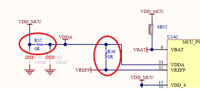

First, you need to ensure that R36 and R37 are available:

As per hardware, selecting R36 and R37 are connected on the nucleo board.
So try with OPAMP2.
