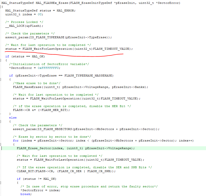

I am using STM32F413 Nucleo board. I am using MDK5 IDE and HAL libraries. I made an example for reading/writing internal flash based upon a cube project.
The idea is to erase interal flash and then to write some data to it. I alreay did some similar porjects but with F0 and F3 series so I am not newbie in that field.
However what I am seeing here is that the first time I load application to MCU and run it it won't erase flash. Then I break it, reset and re-run it and it will erase and program everything perfectly. And from this point on it will always work fine.
To sumarize. Flash erase is not working only the first time right after I load application into flash. Flash unlock returns HAL_OK while flash erase function returns HAL_ERROR. After I break it, press reset and run it again it will work without a problem (no HAL_ERROR for flash function).
I am visualizing data in Memory 1 window where I can see how data is changing.
So my code excerpt is as follows:

Nix Wayne
It fails in function Flash_WaitForLastOperation called by HAL_FLASHEx_Erase with error HAL_FLASH_ERROR_PGP.
Guru
Okay, so look in the reference manual to determine what that means.
The write access type (byte, half-word, word or double word) must correspond to the type of
parallelism chosen (x8, x16, x32 or x64). If not, the write operation is not performed and a
program parallelism error flag (PGPERR) is set in the FLASH_SR register.
Looks like you are not setting PSIZE explicitly in FLASH_CR but are instead assuming it has a given value.
Nix Wayne
Huh... The problem is that I don't even get to the point where PSIZE is set. See attached image. As I wrote in a post above it fails in function Flash_WaitForLastOperation (marked with red on the attached image)... therefore it never comes to the point where PSIZE is set in FLASH_Erase_Sector function. 0693W00000Dq99rQAB.png

Nix Wayne
I followed your idea and found out that PGSERR was always set therfore FLASH_WaitForLastOperation failed everytime... So what is now even more strange... I manually cleared that register and since now everything works just fine and PGSERR never gets set again. Even if I remove my code to manually clear it every time. I made the power off to the nucleo board and it still works... It so strange... it looks like PGSERR was somehow stuck and with my input I forced it to start working again... like in mechanical world - funny though.. Anyways now it's working and apparently it looks very much related to the IDE. Many thanks TDK for helping me out with this one. Much appreciated!!
