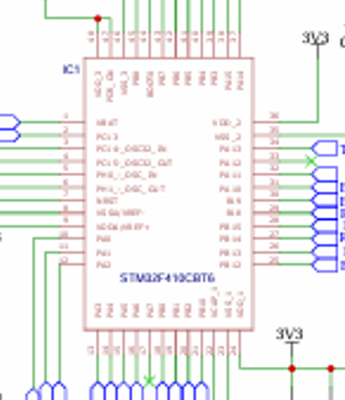

Above is the schematic for the board. I am facing issue for Target not found while connecting with ST-Link.
1. The Vcap1 voltage is 0.
2. What could be the reason for not getting 1.2v at C11. vcap_1 voltage?
Can you please refer the above diagram and suggest solution for the same?

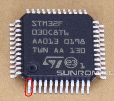

Probably part orientation is wrong. Pin 1 is on the bottom left when text is oriented from left to right.

Perhaps upload a more legible schematic.
Hello Guru,
Here the attached schematic for the same.

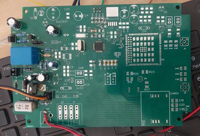

Please provide a large,  clear and in-focus image of the part on the circuit board surrounding it.
Check the 3.3V supply at the side of the VCAP pin. Check Netlist.

One mre observation. i can get 1.17v at PA0 pin,  BYPASS_REG pin. but no voltage at VCAP.
should i connect the PA0 to 3.3?  does it the reasone that i am not getting device detected at ST-Link
ndorugad
What is the PDR level recommended, in my case i have connected the PDR to 3.3V. is it ok?
Also could you please check the schematic and help me to find the issue.

 Here is the top view of PCB.
So chip is treating PA0 as VCAP. Sure sounds like a part orientation issue. Unfortunately, your picture is not clear enough to read the text on the chip.
Pin 1 on the chip is here when text is oriented as shown:
