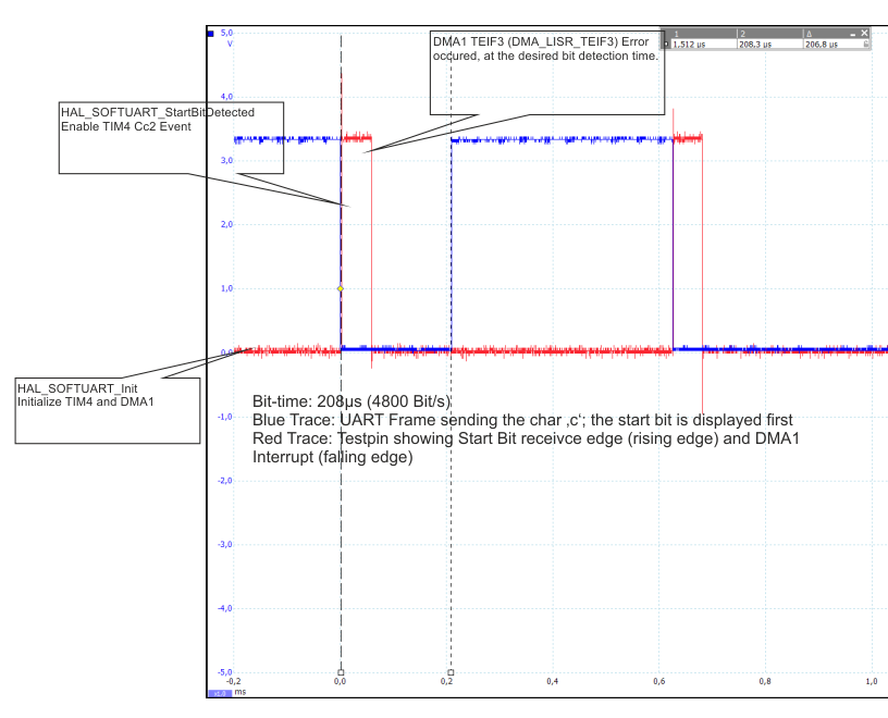

I’ve successfully running the software uart described in AN4457 (Implementing an emulated UART  on STM32F4 microcontrollers) using a STM32F401CE MCUs. The Software is reduced to bare metal and using TIM1 to generate the receive bit sampling event for DMA2 to read the corresponding IDR of the Port. Following Resources from DMA2 are used
RX Line: DMA2 Stream 2 Channel 6 [TIM1_CH2]
The events from TIM1 are generated from CC2DE (TIM1->DIER) correctly.
When I move to TIM4 I use DMA1 with following resources:
RX Line: DMA1 Stream 0 Channel 2 [TIM4_CH1] (see Table 28. DMA1 request mapping (STM32F401xB/C and STM32F401xD/E))
Now I changed Registers from TIM1_CH2 event to TIM4_CH1 event for Bit Sampling generation and the following situation occurs:
0693W00000WI83qQAD.pngThe start bit is detected correctly and initializes the TIM4 to generate the event. When first sampling event occurs a DMA Transfer error occurs, when using TIM1 instead everything works correctly. Anyhow MPU is not initialized.
Following HAL_SOFTUART_Init Routine is used with TIM1 (working case, relevant snippet):
TIM1/DMA2 and TIM4/DMA1 are initialized the same way, timing and registers; With TIM1/DMA2 everything works fine; using TIM4/DMA1 causes a DMA_ TEIF3 interrupt.
Question: Are there any further differences between TIM1 and TIM4 except the missing Units/Register Bits described in the reference manual?

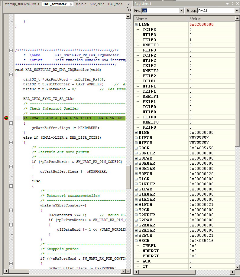

The second Version produced TEIF3 interrupt from DMA1 in the DMA1 Stream 3 Interrupt. Is there any hint what could be the reason?

waclawek.jan
There is no route from DMA1 to GPIO in the busmatrix.
http://www.efton.sk/STM32/gotcha/g30.html
