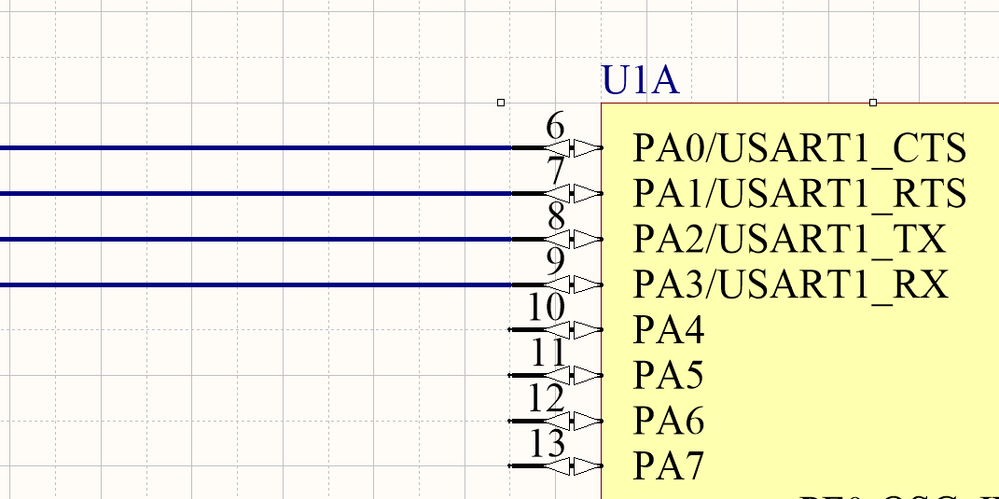

hi

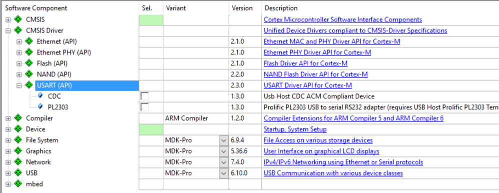

first i look here
but there is no usart driver.
this is my schematic
according to schematic i use pa2 and pa3 as usart.
please tell me if there is any library to init usart and use it.
if there is not .
datasheet give me something but its hard to understand . what to do?

but line 3 and line 4 is so hard to get . why 5*4 why ((9-8)*4)) :!
please somebody help me

Hi
ansari.navid
What you are sharing is a snippet code available in the reference manual of your product.
It is based on direct access to register.
In the package
http://www.st.com/content/st_com/en/products/embedded-software/mcus-embedded-software/stm32-embedded-software/stm32snippets/stm32snippetsf0.html
, you have a set of ready to use examples.
More other advanced examples that are well described and allow you to use USART based on a given STM32 board are available in the
http://www.st.com/content/st_com/en/products/embedded-software/mcus-embedded-software/stm32-embedded-software/stm32cube-embedded-software/stm32cubef0.html
package.
You can also generate your own example thanks to the
http://www.st.com/content/st_com/en/products/development-tools/software-development-tools/stm32-software-development-tools/stm32-configurators-and-code-generators/stm32cubemx.html
-Amel
