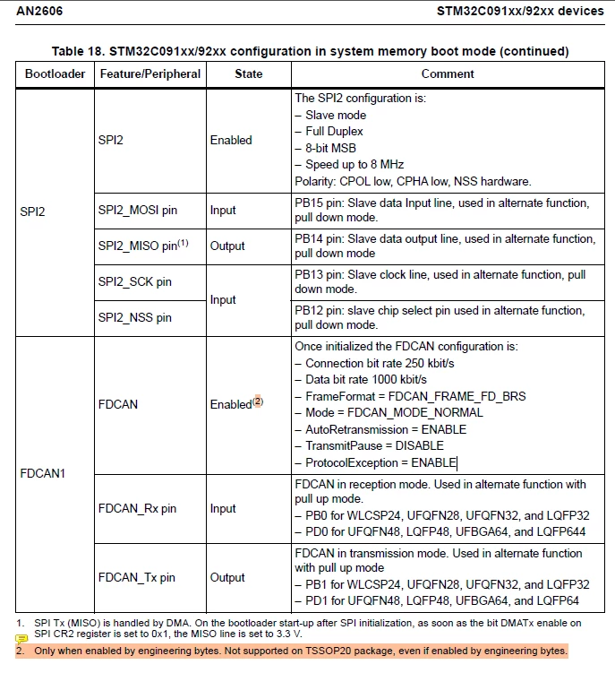

Hi everyone, i just want to be sure cause it's the first time playing with the bootloader.
I have a STM32C092 (TSSOP20) an i was wondering if i can flash it through FDCAN, but reading the AN2606 i unfortunately found a postilla as following (page71):
Flashing through can with a TSSOP20 isn't possible, after a second look even the datasheet said the same thing.
So there are any other method to flash through FDCAN?
My only option seems to be boot from RAM and writing my own bootloader into the application, it's that correct?
Thanks,
Sander
You have interpreted things correctly. As the documentation implies, the only method to flash through CAN on that chip would be to create your own custom bootloader. This will require you to first flash the bootloader using some other method.

Hello @Sanderthunder ,
ST has developed an open bootloader for the STM32C0 FDCAN. It is available on the last STM32Cube_FW_C0_V1.3.1, you can find it in Middlewares\ST\OpenBootloader.
You can also find the github following this link: https://github.com/STMicroelectronics/stm32-mw-openbl

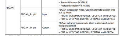

Hello @Sanderthunder and welcome to the ST community,
Indeed you need to develop your custom bootloader. And the Bootloader is not available in this package because it doesn't have the necessary FDCAN pins used for the bootloader available for this package:

You can use the openbl on this package. The goal of open bootloader is to give the possibility to have a customer bootloader. For information, you can configure the FDCAN pin in the interfaces_conf.h of the open bootloader project.
