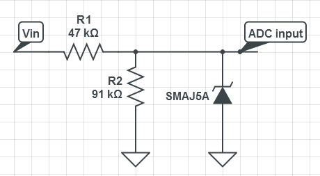

I want to protect my ADCs from overvoltage and ESD, and limiting the input to 3.3V.
This is my schematic:
There is a voltage divisor to convert 5V >  3.3V.  The top resistor is also used as the diode resistor.
There is a lot of special diodes in the market: TVS, zener... Do you know a part number which can fit for my application ?
Thanks !

I use the ST USBLC6-4 series TVS diode arrays.  They are intended for USB but work well as a low capacitance TVS diode.  The array clamps the input line to the power rails.   I like the USBLC6 since it has either 2 or 4 diodes for multiple channels plus a fast breakdown diode between ground and VDD.
For single diodes and no line clamping I use the NXP PESD series TVS diodes for 5V and 3.3V lines.  For 24V outputs (common in industrial process control) I use the Vishay QSBT40 TVS diode array.
I also use zeners to clip the input voltage to an ADC channel in cases where the ADC VREF is below the VDD power rail.

a Zener is too slow for transient suppression
Erik

Thanks ! I also use the PESD5V0S1 for my resistive touchpad input. I think I will use it for my ADC inputs.
