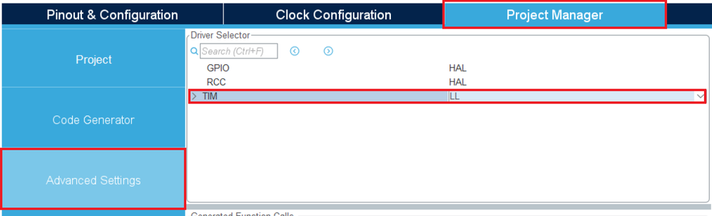

It seems that CubeIDE can use the LL library to generate TIMers in Encode mode?
YLi.13
Thank you for your answer
Hi @YLi.13​ ,
Yes, you can use the STM32cubeIDE to generate Tim_Encoder project with the LL library.
After configuring your project with STM32cubeIDE, you can click at project manager/advanced settings and choose to use LL drivers in driver selector as shown in the below figure.
_legacyfs_online_stmicro_images_0693W00000bhfSoQAI.pngDoes it answer your question?
If your question is answered, please mark this thread as answered by selecting Select as best, as also explained here. This will help other users find that answer faster.
Thank you.
Kaouthar
YLi.13
And I found in the STM32F4 series LL library manual that it can drive the Encode mode of TIMer, so may I know how to understand "The LL TIM_Encoder example is not available in STM32CubeF4 package with STM32F446 MCU, but you can get inspired from HAL TIM_Encoder example."?
