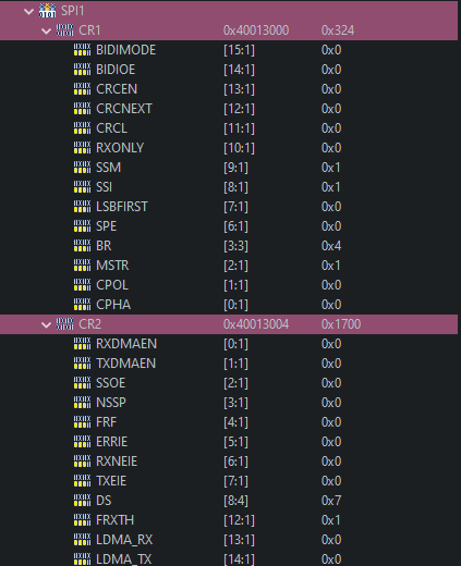

Hi everyone,
I can not get SPI using the DMA to work. The MOSI line stays zero all the time. The result is the same using my own and also the example code provided with the firmware package for the MCU (STM32CubeL5\Projects\NUCLEO-L552ZE-Q\Examples\SPI\SPI_FullDuplex_ComDMA_Master).
On the other hand, if I use a busy transfer (HAL_SPI_Transmit(&hspi1, aTxBuffer, BUFFERSIZE, 100);) the MOSI line outputs data as expected, which makes me believe that on the SPI, GPIO side things are working fine.
I guess there must be some configuration that I am overlooking. Still, it surprises me that the example is not working.
Any ideas?

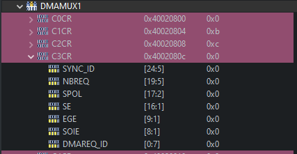

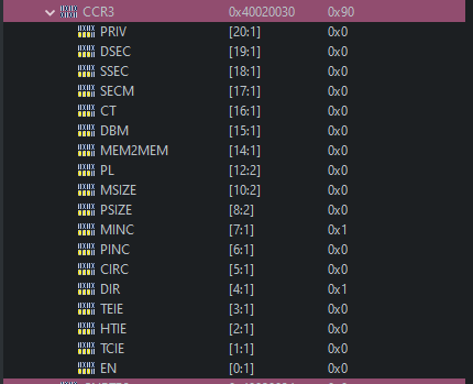

If you are sure GPIO is set correctly, read out and check/post content of SPI and relevant DMA/DMAMUX registers.

‎2022-11-04 5:38 AM
Thanks for your answer!
These are the register values after running MX_DMA_Init() and MX_SPI1_Init() functions but before running HAL_SPI_TransmitReceive_DMA([...]):
