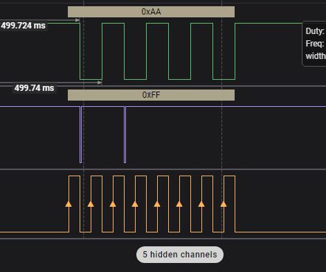

Hi everyone! i am using stm32l0c6t6, i need use spi with register, because i need make function type: spiwriteread(uint8_t data), to write in the device Lora llcc68 and read the return register, but with hal i can´t. Then i have configurated the spi using register, but when transmit i read in the logic analyzer inverter data, example: i transmit spiwriteread(0x55); and the logic analyzer had 0XAA; i don´t know why this is ocurr because the configuration register is rigth. i going to put the complete code:

Off by one bit could also suggest CPHA and CPOL settings are mismatched between logic analyzer and spi configuration. Show the logic analyzer trace for sending 0x55.
Are you sure it's inverted and not an MSB / LSB interpretation. Perhaps try a different pattern.

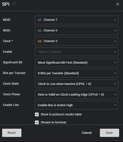

my logic analyzer is configurated as: spi_conf.JPG

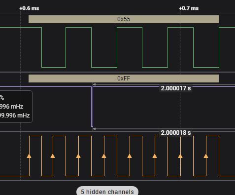

but i test with hal send 0x55 and similar configuration and the logic analyzer i view 0x55.

 i send 0x55 and i view 0XAA in the logic analyzer:spi1.JPGspi_conf.JPG

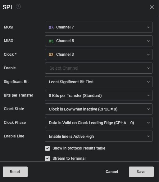

"Perhaps try a different pattern" ,  i don´t understand with different pattern, but i send 0x55 with library and i view 0x55 with the similar configurattion of logic analyzer, but if i put "least significant bit first" in the logic anlyzer the spi is 0x55.spi_data2.JPGspi_conf2.JPG
jdo
this spi is rigth because for send first MSB the logic analyzer view the bits inverter.
SPI is MSB first by default. Perhaps check it against other patterns that would clearly expose the difference in bit order. 0x0F, etc.
