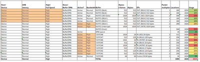

Thank you for your reply. My current FIFO configuration is:
  • SetRxFifo=512
  • ep: 0x00 SetTxFifo=128
  • ep: 0x81 SetTxFifo=16
  • ep: 0x82 SetTxFifo=124
  • ep: 0x83 SetTxFifo=17
  • ep: 0x84 SetTxFifo=16
  • ep: 0x85 SetTxFifo=16
  • ep: 0x86 SetTxFifo=16
  • ep: 0x87 SetTxFifo=128
  • ep: 0x88 SetTxFifo=24
The TxFIFO sizes are based on the maximum packet size in the USB descriptor for that endpoint (except for the control endpoint, whose maximum packet size is 64 bytes). The total fifo size is 3988 bytes, which is less than the 4096 bytes of USB FIFO RAM available. The endpoint 0 size is larger than 0x10 because for some interfaces I am sending more than 64 bytes for the control packet (understanding that when the host requests more than 64 bytes from a control endpoint that those bytes will be split into multiple 64 byte packets. I thought that making the EP0 TxFifo larger would allow me to prestuff all the data to be sent to the host for the control endpoint into the TxFIFO).

Hi @drmadill
Even with packet multiplier 1 each this is not feasible. The minimum TxFIFO size for each IN endpoint is the maximum packet size in words for each EP. This depend on the type of each EP not number of bytes transferred.
Best regards,
FBL
The numbers I gave you for SetTxFIFO for each endpoint were in words, not bytes. I notice from your spreadsheet that you seem to have interpreted them as bytes. Also, I am currently using a packet multiplier of 1 for each IN endpoint.
Now, you claim that the maximum packet size in words for each endpoint depends on the type of the endpoint rather than the packet size specified in the USB descriptor for that endpoint (which is less than the maximum packet size allowed by a high-speed device in my case). However, what if I only write a packet to the TxFIFO if it is empty? i.e., the previous packet has already been sent (which is what I doing)? In that case, the TxFIFO will never have more than one packet in it. Would this not be handled properly by the USB core?
