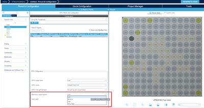

Can I know any available settings to reduce I/O speed. The idea is to reduce power consumption by F429.
CubeMX doesn't allow to change I/O speed.
7 REPLIES 7
mƎALLEm
Hello @GauravK ,
How?

Reducing the I/O speed actually has less influence on power consumption than on the reduction of EMI.

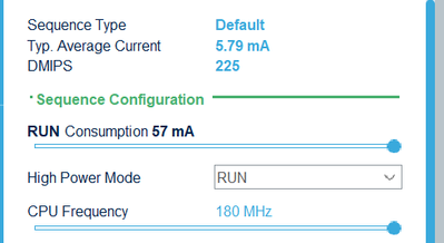

Hello, thanks for all replies. wanted to know then why cubeMX has below options, which lower consumption by reducing cpu freq
Peter BENSCH
You are confusing IO speed with CPU speed. In fact, the current consumption of an MCU depends on the clock frequency, among other things.
However, the IO speed generally refers to the steepness of the edges when switching the IOs (rise time and fall time), which, as already mentioned, mainly has an influence on the interference radiation of the IO, but is almost negligible for the current consumption.

  1. I want to know how to change IO speed, for that there is no solution provided

It depends if the pin is changing state, it's a pin level attribute, worse case you can change in code. Image in SofLits image hard to read/zoom here.
