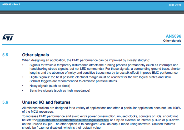

Hello everyone,
I’m facing an issue described in this link: My STM32 device is overheating and has malfunctioned.
My STM32G070CBT MCU has been damaged, specifically from the PC6 pin, which wasn’t in use. Unfortunately, the pin is connected to another device that is shorted to the chassis, and this is a finished product that has already been released. Here’s what I cannot do:
  • I cannot modify the PCB design.
  • I cannot add protection diodes.
  • I cannot cut the cable.
Given these constraints, is there a way to protect the MCU without hardware changes? For instance, could setting PC6 to pull-down mode or output mode help mitigate the issue?
Thanks!
@Wadeva wrote:
Hello, I’m a bit confused.
Likewise!
Pulling an unused pin to ground shouldn't cause any problems at all - in fact, it is a common practice to do so!
https://www.st.com/resource/en/application_note/an5096-getting-started-with-stm32g0-series-hardware-development-stmicroelectronics.pdf
The only problem would be when it is configured as an output and driven high.
Or left unconfigured and floating.

Andrew Neil
If PC6 is configured as an input (which is the default state), that shouldn't matter.
So make sure that PC6 is configured as an input - or just left unconfigured.
Hello Andrew,
This pin indeed unconfigured.
Then pulling it to ground would cause no problem.
Hello, I’m a bit confused. If I configure PC6 with an internal pull-down, will that resolve the issue? Or is leaving the pin unconfigured sufficient for protection?
To clarify: the product has already been distributed, and I can only make changes via an OTA update. If there’s a way to improve safety by adjusting the configuration of PC6, what would you recommend? Or, as you mentioned, is it better to leave the pin unconfigured?
This leads to another question: could a different pin be causing the problem? I will check PCB design a little bit further then.
Thanks for the help.
