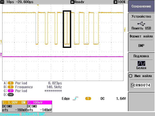

Not sure I understand the failure mode you're trying to describe.
Are you able to see the PWM signal on the pin? Which pin specifically? Your code lacks defines. Are you able to modulate the PWM with the DMA buffer? You probably need to initialize memaddr to zero. Nine or Eight bits? Is it stuck in the DMA TC while() loop? Do you need to turn this on/off, or can you send a continuously modulated stream of bits?
>Are you able to modulate the PWM with the DMA buffer? >Is it stuck in the DMA TC while() loop? Here my defines: #define DATA_PIN GPIO_Pin_4 #define DATA_GPIO_PORT GPIOB #define DATA_GPIO_CLK RCC_AHBENR_GPIOBEN When I set request event CC1 I see PWM (attached pictures). I modulate PWM form DMA buffer, but I have one troble with this (see marked osciloscope diagram). Timer get 2 pulses for one period and two signals is sticking (I think that happen 'couse I set CC1). I want to initialize request event update but then I lacks in while() loop. while(!DMA_GetFlagStatus(DMA1_FLAG_TC4)); I >You probably need to initialize memaddr to zero. Nine or Eight bits? Yes, I set 8 bits to zero. >Do you need to turn this on/off, or can you send a continuously modulated stream of bits? If you call Transmit9Bit() it send 8 bit (pay no attention to the function name).#include ''2WireInterface.h''
