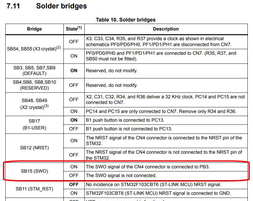

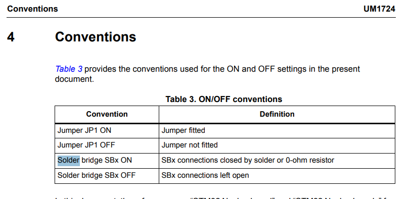

SB15 is a Solder Bridge.
A Solder Bridge allows a connection to be made or broken - they perform the same function as jumper links:
Specifically, SB15 allows the SWO connection between the STM32F303RE microcontroller and the ST-Link to be made or broken.
The link needs to be "made" to connect the SWO from the STM32F303RE microcontroller to the ST-Link.
ST seem to have omitted to mark which is the default here - so you'll have to check by looking at your board
@STOne-32 - the bold highlight on the default option seems to be missing for a number of them.

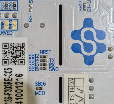

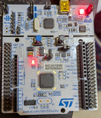

This is the board I got
So check to see if SB15 is open or closed
I am new to this, What exactly need to be checked in the board
This is how it looks
