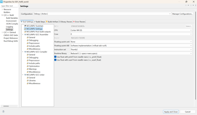

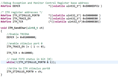

I am trying to use SWD for printing using ITM_Sendchar, Printf not calling _write, I tried to put breakpoint and see, But it is not hitting breakpoint
hegde_08_0-1765201262291.pnghegde_08_1-1765201284864.pnghegde_08_2-1765201298919.pnghegde_08_3-1765201309930.png

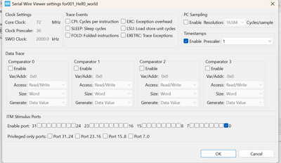

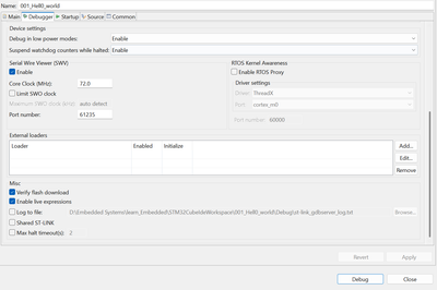

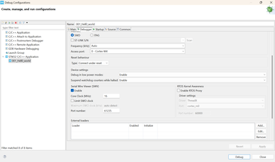

Best answer by Tesla DeLorean
Clock speed needs to match.
Doesn't the STM32F3 have a default HSI of 8 MHz?
Use that speed.
Perhaps also output to the VCP USART so you can see in a Terminal app, and print out SystemCoreClock to confirm.

By default, stdout is line buffered. You will see output only after a newline '\n'. Less common: stdout buffering might be changed to unbuffered as well.

As @KnarfB said, stdout defaults to line-buffered, so you won't see any output until a newline is sent.
This is also noted in the Knowledgebase article, How to redirect the printf function to a UART for debug messages.
See also: https://community.st.com/t5/stm32-mcus/how-to-redirect-the-printf-function-to-a-uart-for-debug-messages/ta-p/49865#:~:text=5.2.%20Line%2Dbuffering,has%20been%20formed - which includes how to disable the line-buffering.
Also Try:
printf( "Hello World!\n" );
instead...

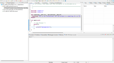

hegde_08Author
December 8, 2025
I just came here to give update, So _write is called, But now Even though I enabled SWD, and trace, and Port 0, Print is not working

Board type? (If ST.) Schematic? (If your own.)

STM32 , NUCLEO-F303RE

Is the SWO pin configured in CubeMX?

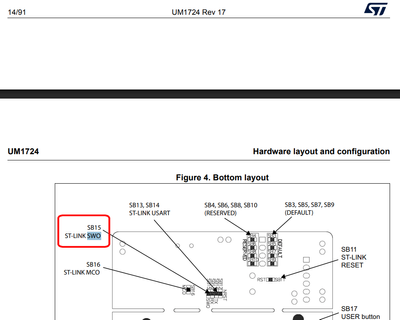

hegde_08Author
December 9, 2025
This is the board I got
Andrew Neil
December 9, 2025
So check to see if SB15 is open or closed

Tesla DeLorean
Tesla DeLoreanBest answer
Guru
December 10, 2025
Use that speed.
