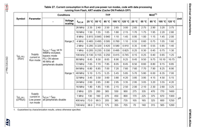

hello all;
i wondered if there are good guidelines for power consumption vs. clock, and, how low can the processor clock run? complex, i think, especiallly if one needs to run certain peripherals like ADC, or i2c... thanks!
Andrew Neil
Very often, the lowest power consumption is better achieved by running the processor at full speed so that it can get stuff done quicker, and then sleep longer.
Look at the peripherals' facilities to run without CPU intervention...
Only run the peripherals when actually needed ...

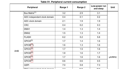

AScha.3
looking at ds of your chip might give information...
also for each peripherals..

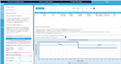

+Check with power calculating tool in Cube, if you prefer ...
